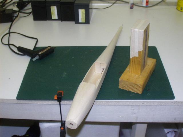

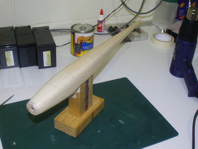

Okay, just sat down after putting the 2nd coat of WBPU onto the fus (glassed with 25g/m.sq)
Here's a couple of photos.
Shaped fuselage waiting to be covered
Fuselage mounted onto its 'stand', this allows me to move the fuselage around without having to touch it directly.
Waiting for the first coat of WBPU to dry. I initially painted the fuselage with one coat, applied the glass when it was still sticky (it pays to wait 10 mins rather than trying to put it on immediately)

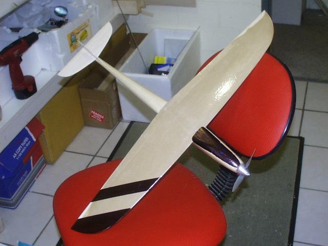

FINALLY, at long last I'm done...(well, it can now go for a maiden flight)
Paul.

Flight Report
Well, the Slipso400 (#2) has survived, isn't that all you needed to hear?
Speed has definately improved (I suspect because the wing is a lot slicker than the CA/glass) but the model isn't as responsive (because it's more nose-heavy this time) however that's not a big issue as I'm still getting used to the pace.
The slipso holds a 30~45 degree climb but won't pull might further than that without slowing up.
Landing is a bit hotter though fortunately with the experiences from last time it's not so fear-inducing, I just chop the throttle as it passes me going down-wind, travel another 30~40m, turn around, wash off speed and height, line it up and slowly feed in some elevator and it _usually_ landed near enough to me.
All up I'm very happy with this build, it's progress from the previous one.
AUW is 373g with a 128g 8 cell 5/4AAA 830mA NiMH pack.
Paul.
