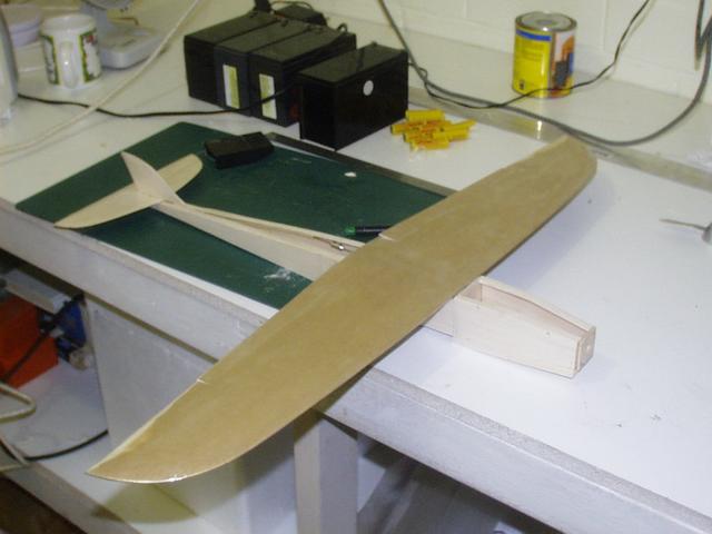

Current state of affairs -
PLD is offline Find More Posts by PLD

Okay, it's 01H45 here, time for me to head off to bed.
Managed to get the triangular stock into the framework... why I don't do this _before_ I assemble the sides together I will never know.
Paul.

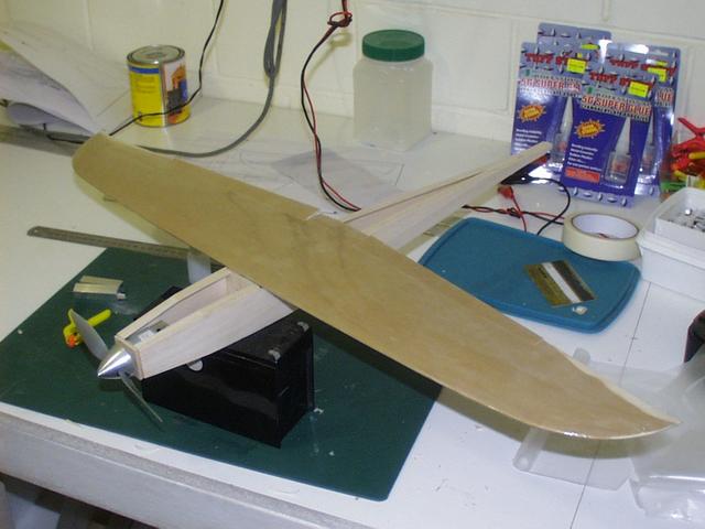

Got the tailplane done and started sheeting the top/bottom decking of the fus. Elevator servo is installed and the pushrod/wire guide.

So, what mods are you going to do? I've already done a couple myself, as I said, a never ending process of adjustments.
Even though I've not even finished this one yet, the next one I'm going to use a 3 x 3.2mm laminate for the wing so that I can get some real airfoil section into it and help cut the drag down through the turns (plate-like airfoils are horrible for moves like that). I've also already changed the orientation of the elevator servo so that I can put the tristock all the way up to F3, letting me get some more curving in.
