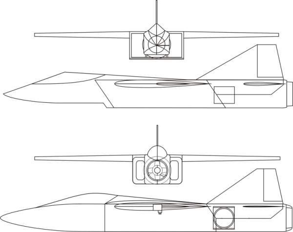

The top drawings are the first draft. An interesting look, but I felt the nose could create turbulence and it was pretty lean in terms of interior space for the radio gear. The intakes were also too large and their angular side profile extended the duct unnecessarily.
The lower drawings further refined the outer shell. What I'm doing is working on one area at a time (basically from front to back) using 3 views to make improvements on the areas of function, ease of construction and appearance. There's already some more changes, especially on the tail, but thankfully the outer shell is close to its final form now.

321,
Looks great, been folowing along on the inlet thread as well. Hopefully I can have something to post from my project tomorrow.

I like it, esp the new nose, very nice. One thing to keep in mind is the wing incedence, I would advise you to make it easy to alter, not much, but allows a little fine tuning of the flight atitude. It almost looks like your slightly negative, with a sym or semi sym airfoil I would think a little positive would work better. Keep it coming.
