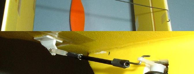

The advanced instructions showed a short piece of CF rod embedded in the control surfaces to create control horns. I used the included control horns, but cut them way down to save weight and increase the throw potential.

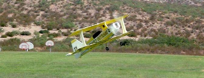

The Outrage 3D was the first of the two off the building board. It looked so good sitting there on the bench that I just couldn't wait any longer. It was late evening and the wind was 5-10 with gusts approaching 15 mph. Not the best conditions for a first flight, so I flew anyway of course. I advanced the throttle slowly and after an initial humming chirp from the outrunner, the Outrage rolled forward on the pavement.
This was my first outrunner and I was amazed at how quiet it was while really moving the plane right along. Half throttle got the Outrage moving briskly and it tracked almost perfectly straight. I can't remember if the plane needed any rudder correction, but if it did, it wasn't much. The Outrage lifted off by itself and climbed at a 45 degree angle. I brought it around, leveled off, and rolled inverted.
A few bleeps of down trim got me hands off inverted flight. I rolled back to upright and noted that I also had hands off flight in this attitude, off to a great start! The rearward CG in the instructions was apparently the sweet spot for this plane. I put the aileron stick hard over and got about 3 rolls per second with only a moderate drop of the nose.
The wind gusts knocked the Outrage around a bit, but the control authority was so positive that it didn't give me the jitters at all, even though there were plane-hungry trees all around. I'm sorry, I just have to say it, it flew like it was on rails, (I apologize again for using that old tired one, but I feel so much better now).
I tried a knife edge and as expected the Outrage performed it with minimal rudder or throttle. In the wind it was impossible to divine coupling if any. I'd tempted fate enough at this point and lined up for a landing. I chopped the throttle and the Outrage didn't even seem to notice. Speed and attitude remained the same, it just started to slowly lose altitude. As it approached the ground I kicked the nose up and poured on the coals with the throttle stick. The Outrage slowed to a crawl and then touched down softly with about a foot of roll out. What a great first flight under less than ideal conditions.

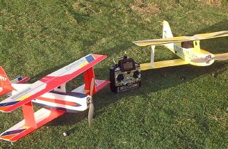

Comparison... Which One Is Better?
So many great models, so little time and money! You say you can't afford to buy both and/or don't have the time? Which one to buy? This part of the article should help you decide.
Physical Differences
Both the Ultrafly Bipes are truly awesome looking models you'll be proud to own and fly, but there are some differences. The Outrage 3D really reminds of an Ultimate or other competition class 3D biplane. With its larger scale fuselage, traditional outline tail feathers, and rearward swept upper wing it looks just as great sitting on the ground as in the air. I have to give the Outrage 3D the nod on looks alone, but it was a tough call.
The Furious 3D on the other hand leans a little more toward "form follows function". The fuselage is quite a bit narrower with just enough room for flight gear. Wing area is down slightly, but control surfaces are much larger for that little extra during high alpha maneuvers. The smaller Furious fuselage does require a little more planning on gear placement during assembly than the roomy Outrage.
Flight Differences
The Outrage 3D really sliced through the air with pattern like performance. Maneuvers were crisp and precise with a feeling of exacting control. The Outrage definitely handled the wind quite well. Some bouncing about did occur as you would expect of 10-12 ounce plane, but this didn't lessen the feeling of control or cause the flying session to end.
The Furious 3D on the other hand was definitely the more 3D inclined of the two. It had more of a floaty anti-gravity feel in spite of having slightly less wing area at the same weight. Control response was up during all aspects of flight which was expected with the larger control surfaces. These attributes were great for 3D but made for liabilities when the wind kicked up. The Furious was not nearly as tolerant of the wind as the Outrage.
So which one is the plane for you? They are both excellent fliers and fully 3D capable, but if looks, patterns, and windy day flying are important to you, get the Outrage 3D. If high alpha is what you crave over all else, the Furious 3D is your plane. Either one will not disappoint.

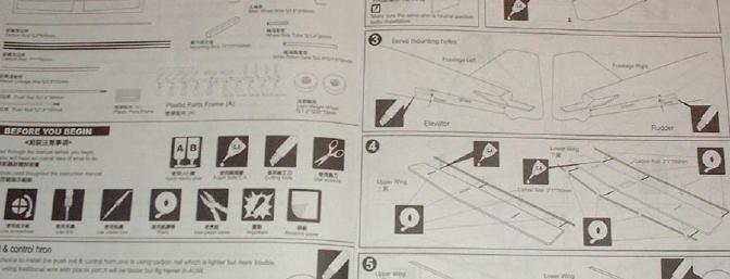

  • Instructions Confusing

I'm a proud owner of the Outrage 3D and think it's a great machine. I just want to add some of my own experience of this plane. As I can judge from the above discussion, my setup for this plane came out a bit to heavy, but I can still perform all the different manouvers and get appr. 10-15 min of flying. The heaviest LiPO I use weighs in at 116 grams (1500mah). The effects of this is that, as Jim mentioned, you loose that "floaty" feeling and straight flight needs more throttle (I recommend being outdoor flying).
In addition, I used the standard piano wire for all the linkage. And a tip for future winter flying. I've made skiis out of a plastic bottle for soda drinks. Use the bottle neck as the front of the ski. Then you put two ribs of depron on each side of the landing rod.
