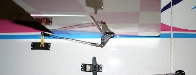

I used Futaba S9206 High torque digital servos on the elevators and rudder and they fit in the opening perfectly. I used Dubro heavy-duty servo arms on everything, but I used some aluminum ones on the elevators with Dubro ball links as I had them in my spare parts box.

Good job on the review. Two things I have noticed on mine.
1. The fuel tank might be a smidge high in the fuselage. If I am not careful I can siphon the entire tank of fuel though the carbureator (inverted motor). I would guess this could be prevented if the fuel tank was an inch lower. I noticed the author of the article seemed to have a similar experience.
2. The main landing gear are two piece which means they are not joined in the center. Any Giant UCD owners should fabricate a aluminum strap with 4 bolt holes to tie the left and right landing gear together. I set my bird down hard one day with out the strap and folded both main gear.

Thanks.
Your right about the gear, I was doing a low elevator today about 5-10 feet off the ground and was going to try and land it that way, well I did when I ran out of fuel and it plopped right on the gear breaking the wood and spreading them out. If the plate was in there it might have just bent them or it could have done more damage I don't know.
