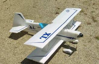

The UZI XL is a smart looking and rugged aerobatic biplane, that is compact enough to stuff into the smallest car. Assembled from a relatively small number of EPP foam parts, its mere 5 oz. per square foot wing loading allowed it to virtually float off the ground and fly with a gentleness a near-beginner can handle, yet still power into snappy aerobatics. In all, this little Czech made airplane has a lot going for it.

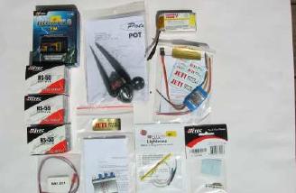

The UZI Xl came in a compact flat box with a useful full color photo on top. Inside, I was surprised to find the various EPP pieces packed with no protective foam, dividers, or plastic bags. In spite of the lack of protective packing, everything arrived with no damage whatsoever. In addition to the EPP parts, the box contained an instruction booklet, a sheet of blue peel and stick decorations, and a plastic bag full of small parts. Everything else needed for completion was supplied for this review by Hobby Lobby and can be purchased from their web site. The quality of the kit materials and of the components supplied by Hobby Lobby was excellent.

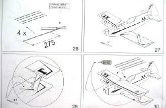

The UZI XL kit contained a 15 page instruction booklet supplemented by a full size fuselage profile drawing printed on two 12x16 inch sheets. The instruction booklet contained 80 line drawings illustrating assembly, 5 illustrating control throws, 1 indicating how the carbon fiber rods should be cut, 1 page of airframe and ESC specifications, and a final page of diagrammed controller programming settings.
Note:The entire “Building Guide” (Potensky's term for the instruction booklet) can be downloaded from Potensky’s web site.
This kit was suitable for those who have successfully constructed fairly complicated "foamies", but no written instructions were included. With only the minimally labeled drawings to bo by, assembly would have been a difficult task for anyone without substantial experience.
Manual
There were several places where I had to sit and give the more cryptic steps some serious thought, for which reason I have created a separate document to go into more lengthy detail of virtually all the assembly steps. If you're getting ready to build this airplane, I hope you'll find the more detailed page helpful! If you're not quite ready to buy it yet, then this article will give you a briefer overview of what you have ahead of you.

As an initial illustration of the difficulties with the instructions, the first drawing (shown above) illustrates attachment of the fiberglass firewall to the fuselage front. Above the drawing of the firewall being attached to the fuselage, a razor saw is shown cutting what appear to be two dowels that are pointed at both ends and fully as long as the razor saw. What? After searching through the kit for some sort of dowel as long as a razor saw, I eventually realized that what was being shown cut in half were toothpicks that are included in the kit! The toothpicks were shoved into holes in the corners of the firewall and served as pegs that reinforced the joint. I knew I had a bit of a challenging assembly ahead of me. The kit turned out to use the toothpicks in a variety of key areas and in a variety of ways.
