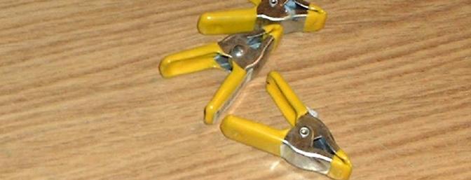

The wing halves were very easy to assemble since I had many small clamps available to hold things in position. At first I was considering glassing the center section of the wing after it was assembled. However, I decided that the hefty wing joiner, ample glue points, and plywood servo mount that was glued between the halves supplied enough strength for aerobatics as designed. Of note was that many of the screws needed for assembly and called for in the instructions were missing from the hardware package. The missing hardware were very common items, so I was able to replace them from my spares drawer. Hobbico assures me that customer's production aircraft should be complete, and any missing items would be replaced promptly.

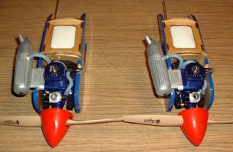

Engine Installation

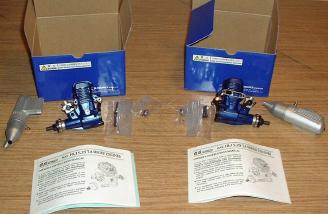

All necessary hardware, fuel tanks, motor mounts, and spinners were provided in the ARF kit. The adjustable mounts were very nice and the fuel tanks fit just right in the nacelles. The only problem I had was connecting the linkages. The instructions called for using a clevis on the end of the supplied pushrod wire. This was to be connected to the control arm on the engine's carburetor and then the wire bent to provide free movement to each throttle servo. There simply was not enough clearance between the clevis and the engine crankcase no matter how I bent the wire to get free movement. I ended up installing quick links on the control arms and just running the pushrod wire directly into each link. This eliminated the interfering clevis and made for a much freer and straighter run to the carb from the throttle servo.
The only thing of note here was that the supplied nose gear needed substantial filing. The flat spot for the control arm set screw had been stamped into the wire. This deformed the wire just enough so it would not slip through the collar in the control arm. I twisted and pushed for several minutes and then twisted and pulled for several minutes to get it out when it wouldn't go all the way into position. A few minutes with the dremel tool took care of that problem. Later when I was attempting to set the rudder throws, I couldn't get enough throw in one direction. The problem was traced to the nose gear. Once again the flat spot for the set screw was causing problems. It wasn't stamped off center enough to allow the control arm enough movement room when attached. Out came the nose gear again and the dremel tool came into play a second time to solve the problem.

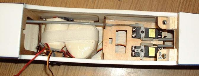

A Y-harness is called for in the instructions, but I chose to hardwire the connection between the two throttle servos for simplicity and reliability reasons.
Radio installation was a breeze on the Twinstar. There was plenty of room for standard size servos in every specified location. Hobbico C60's were used throughout to keep the cost down and provide plenty of torque for all surfaces.

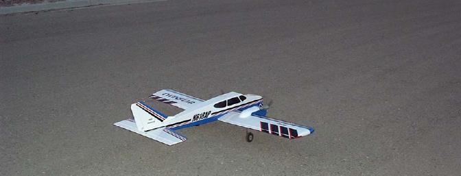

First Session
To my good fortune, the first weekend after I completed the Twinstar had beautiful flying weather. I showed up bright and early at the flying field and flew a couple of other models to get warmed up. Before flying the Twinstar throws were checked and adjusted to the high rates listed in the instructions. The CG was also double checked to make sure it was still at the rear of the range listed in the instructions. At last I got my nerve up and fired up the .25's. This was the first time I had both engines running at the same time and boy, what a sweet sound it was! Having run out of excuses and things to check it was time to launch. I lined up down the runway and smoothly advanced the throttle to full. The Twinstar accelerated straight ahead and required no rudder input. I waited for it to lift off on it's own and when it didn't I pulled just a touch of elevator and the Twinstar rose gracefully into the air.
After a few circuits I was already feeling comfortable due to the smooth and stable flight characteristics of the Twinstar. The sound of the twin engines put a big smile on my face and drew appreciative comments from the flight line. I then got up to a couple of mistakes high and input full aileron. This rewarded me with a slow but smooth and steady roll. The nose dropped slightly while inverted so I input a few clicks of down trim and tried another. This got me very close to neutral pitch stability either upright or inverted. Awesome!! In fact those two clicks of down trim where the only adjustments needed. Next I pulled a fairly tight loop and the Twinstar powered right through it without a hitch. I wanted to get a feel for landing speed before it was actually time to land, so a few touch and go's were then tried. I didn't have the throttle travel set quite right and the two .25's were still revved up slightly even at the lowest stick position. This made the approaches pretty speedy, though not unreasonable. Three touch and go's were completed without a hitch or a bounce and I was getting a pretty good feel for the Twinstar's habits.
After the third touch and go I punched the throttle to swing around for another landing pass when suddenly the Twinstar seemed sluggish. I finished the circuit and lined up for another touch and go. As the plane came closer the reason for the sluggishness was clear, only one engine was running. The realization startled me and the touch and go turned into a rough landing. The rough landing was totally my fault because I lost my concentration when I saw only one engine running. The Twinstar was actually flying just fine on one engine. In fact, the pilots at the other end of the runway said that I lost the engine shortly after I took off from the last touch and go. So I had actually made a complete circuit and lined up for the landing on just one engine, without even knowing it! At first I thought one engine had run out of gas before the other, but closer inspection showed the real cause. Parts of the spinner were missing and the prop was destroyed. That ended the flying for the day because I didn't have extra spinners or props.
Back at the shop I disassembled the other spinner and prop assembly. It was full of stress fractures and probably would have disintegrated soon after the first if I had kept flying. In my opinion the plastic used to make the included spinners was brittle and substandard. Fortunately there was no other damage. I installed some newly acquired spinners and props and the Twinstar was ready for another trip to the field.
