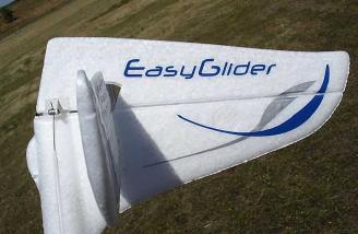

My first love in R/C flying was and remains gliders. When I learned that Multiplex had a new glider kit coming out in both an electric and pure glider version I was delighted to be among the very first in this country to get a chance to fly and review it. The kits are scheduled to be available in the U.S. this June. When I heard the name: "Easy Glider" I thought it would probably be a simple trainer, but when I learned it had ailerons I knew it had potential to be more then a simple trainer. Having flown and enjoyed almost all of the existing Multiplex planes I looked forward to the arrival of my Easy Glider.
There were not a lot of parts and all of the big items were made of Elapor foam. The fuselage came in two halves with a canopy. The wing was in two halves, plus one bottom piece for each half. The bottom pieces allowed them to mold space for both the aileron extension wire and space for the center joiner rod. The vertical and horizontal stabilizers both came in one piece with the rudder and elevator attached to the respective stabilizer. The hardware for connecting the rudder, elevator and ailerons was included in the kit as was the long wing joiner rod. There was a large decal sheet and a 52 page instruction manual in four languages with a six page picture section that all four languages referenced. My Electric kit included a gear speed 400 permax motor with a two bladed folding propeller and a small round counter weight to secure in the tail to help balance the weight of the motor unit. I am happy to report that my Electric version came with a fuselage designed for the motor. Those getting a pure glider will have a different, glider-only fuselage. Said another way, each version has its own fuselage.

The wing came completely formed and there were only a few steps in the assembly process. I first used the Exacto type knife to make two short cuts on each end of the aileron to separate its sides from the wing. Leave the front of the aileron alone! It is molded with a working Elapor hinge.
While the Hitec 55 servo fits the molded space for the aileron servo perfectly, its wire was a little shorter then the design in the wing planned on. A space for the aileron extension wire connecting box was molded into the wing but it was too far toward center to fit the Hitec 55 servos wire. I measured where I needed this space for the connection box and cut one out with my Exacto knife. The two pictures below show the measurement and after I cut out the second space. The connecting box fit fine in the space I made and it was all out of sight.
Using CA I glued the servo wire and extension wire vertically against the front edge of the box molded into the wing. (This was necessary to keep the wire out of the way and get a good fit for the bottom Elapor piece that makes the bottom half of the wing rod box.) When the wire was securely against the side I glued the bottom cover in place using thick CA and kicker.

The plane was easy to assemble. I kept the original box for storing the wings and wing rod when not in use, but the fuselage with tail feathers will never go back in the box. I cut out the decals and added them to the finished Easy Electric glider. Balance point for proper Center of Gravity is 70 mm back from the leading edge of the wing. Using an in-line 8-cell 1050-Kan pack from Cheap Batteries it was easy to obtain balance. With the control surfaces moving properly and C/G obtained at 70 mm back from the leading edge the glider was ready for a test toss and then its first flight. I marked the right aileron connector with red tape so I would know which connector went into slot one on the receiver (the one with red tape) and the one that plugged into slot six (the one without tape by the connector). I tried to balance the plane on the C/G using a 3-cell Lipoly pack but I would have had to add lead further forward to get balance. All flights were with the 1050-Kan pack.
Take offs were performed with a handtoss and landings were performed with the motor off so that the prop folded and it slid in on the grass. If your landing surface is hard dirt or pavement I would recommend that you apply some light weight clear shipping tape on the bottom of the fuselage to protect the foam and replace it as needed. A firm straight forward toss with the motor running started each flight and it did not require tremendous throwing effort, just a good firm toss.
My first flight was with the motor off and was at a large park. I tossed (harder then normal) over a field of nice green grass. I gave a firm toss just slightly above level and the glider sailed out nice and straight for about 30 yards and I started a right hand turn with ailerons and applied a little up elevator as well. The glider banked and made a large 180 degree turn and flew back and landed about 15 yards in front of me. The test toss was a success. With a nearly fully charged 8-cell 1050-Kan battery pack my second toss was again into a very slight breeze but this time the motor was running. I flew forward about 50 yards picking up speed and applied a little up elevator and the Easy began a gradual climb. At about 75 yards out I started a left hand turn and the rate of climb slowed but the plane continued to climb while in a large left hand circle with about a 50 yard radius. After I had climbed to about 300 feet I turned off the motor and was gliding towards the north end of the park. About 300 yards out the glider pitched slightly nose down and yet was obviously climbing. I had caught a thermal on the first flight. I banked to the right and circled while climbing with the motor off. I rode the thermal up a couple hundred feet but had also drifted downwind to the west a couple hundred feet. I had the Easy leave the thermal and headed her back over where I was standing. Penetration into the slight wind was good. I flew for about another twenty minutes with three more powered climbs but didn't catch another thermal that day.
My friend Jeff Hunter flew the second flight at our club's field and I videotaped his flight. The video below is a three minute extract from that flight showing the highlights of his flight as discussed in aerobatics below. The flight was made on a gusty morning and the Easy handled it well.
I have had a couple more flights with the Easy since then and found it to be a very nice glider to fly. Two of my flights were early morning flights with no thermal activity spotted. The Easy has a nice glide rate and turns smoothest using both ailerons and rudder. I had one last flight during a lunch hour before writing this review and after my third power climb or about ten plus minutes of flying I caught a very strong thermal. I might have completely skied out but I was afraid I might loose the Easy with no flaps or spoilers if I stayed with the thermal to long. I need not have worried! It nicely started to come down when I started doing dives and loops and then did some inverted flying as well. It was good that I started down when I did because I had completely lost track of time during that flight and had to hurry back to work after I landed.
This is a thermal glider and not a plane designed for sport acrobatics. It does perform a very nice loop and an OK but understandably sluggish sailplane axial roll with the ailerons. These acrobatics are more of a diversion to perform on your way down after having a successful thermal flight. A victory roll if you would and for that purpose it worked just fine. The power for climb is more than adequate considering it is only a geared speed 400. I have no desire to go brushless with my Easy as I have a Hotliner when I feel the need for speed. Following the plans and using the standard motor set up, the motor and gear box were held in place but not glued. I was a bit skeptical about the arrangement but it proved to work fine. If a stronger motor is used I would recommend doing some modification to the mounting system.
The assembly process is easy enough that a beginner could assemble it and many could fly it. If a person has an experienced pilot working with them and/or a lot of time on a flight simulator they would probably be able to succeed with this plane. However I don't recommend planes with ailerons for beginners. I recommend rudder/elevator planes with polyhedral for beginners to learn how to fly. The Easy Star, while not as good a "glider", based on my experiences is a better first plane. It will self correct to a much greater extent then the Easy Glider and its pusher configuration better protects the motor and prop then the motor and prop in front as done on the Easy.
However, if you want a pure glider (no motor), and have an experienced trainer to help you, the Elapor can take a lot of abuse and you have a good chance of success. I'm waivering but I stick with my position of not recommending planes with ailerons for a beginner...but it would be a great second plane.
I really loved the look of the wings while watching the Easy in flight! Everything worked as it should and the plane showed no bad habits so I only have good things to say about the electric version of this glider. Using the recommended balance point and throws the plane performed flawlessly on all flights. I thought the rear of the fuselage might be a little whimpy when I first assembled it. However, it performed well in actual use with solid control in flight even in windy conditions or during a 200 foot dive and the ending pull out. The Cheap Batteries 1050-Kan pack balanced the plane perfectly so I dropped the idea of using Lipoly batteries in my Easy. I look forward to hearing how the pure glider (no motor) version performs. My motorized version with the 1050-Kan pack is heavier than the target weight of 880 grams, but my Easy handled its weight well. I suspect I will soon see club members flying the pure glider version when it becomes available. Many wanted to know what the planes would sell for and how soon they would be available.
