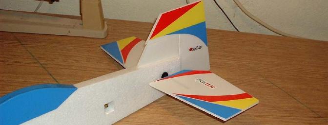

The instructions suggested using 5 minute epoxy to assemble the full flying horizontal stabilizer. I did and was satisfied with the results, although CA might also be used. Pinned hinges were supplied in the kit, but I prefer CA hinges. I used CA and the CA hinges to make short work of hinging and installing the rudder and vertical.

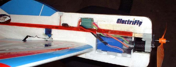

Radio installation took one evening and was pretty straight forward. There were pockets for all the components and the servo holes fit my HS-55's with only slight modification. It was definitely a nice change of pace to have all the wires and components tucked away instead of hanging out and taped on the surface. I used a hot glue gun to attach the servos, receiver, and ESC to the airframe. This worked well except for the aileron servo where I was gluing directly to the EPS foam. The heat from the glue kept melting the foam before it cooled and set up. I unplugged the gun and then waited until the glue was cooler but still liquid. I was then able to finish gluing in the aileron servo.
All the hardware was included and acceptable with one exception. The pushrod for the rudder just wasn't up to the job. All the pushrods, (ailerons/rudder/elevator) were made from fairly thin wire with a "V" bend in the middle. This "V" bend allowed adjustment of the pushrod's length which facilitated mechanically centering the servos and surfaces. The wires for the ailerons were very short and so were OK. The elevator wire was a little longer, but since there was nearly zero resistance because of the full flying stab, it was adequate. The rudder however was a different story. It's wire was quite long and after adjusting the "V" bend it flexed and bent when actuating the rudder. I couldn't get anywhere near the "high rate" throws listed in the instructions. The instructions addressed this problem briefly and suggested attaching a second piece of wire across the "V" by wrapping thread around the two and wicking in thin CA. After some thought, I snipped off the ends of the wire and spliced in some CF rod I had left over from another project. This seemed a better solution to the problem and added no extra weight. Last I installed the included "wobbly" prop adapter and 10-4.7 slow fly prop. These were very nice and added a lot of value to the kit in my opinion.

Since I had one of the batteries the instructions recommended, (the Electrifly 1500mah 3S), I chose to try it first. I had done a review of it in an earlier article and knew this battery would give the included ball bearing 280 sized brushed motor all it could handle. I put my whatt meter in line and it reported around 8.8 amps. This was good, but from experience I knew this motor could have done better. I live at 4000' feet ASL and I was sure the 10-4.7 prop was probably included based on sea level testing. I switched to a GWS 11-4.7 and tried again. This time the meter reported 9.6 amps static which I'm sure was closer to sea level performance. At that current draw the plane's power loading was a nice 109 watts per pound, from a brushed system no less!
Surprisingly, with the Electrifly 1500 3S installed, the Yak 55 was seriously nose heavy when I did the final CG check. The instructions called for the plane to balance 3 inches back from the leading edge, but it balanced well forward of that at a little over 2.5 inches. The 1500's fit the battery case almost exactly, so there was no way to adjust the CG other than adding lead somewhere. I really didn't want to add lead at this point because according to my digital scale, the Yak 55 was already at the max weight of 14 oz quoted in the instructions. Since I was going to be either over weight or way off the specified starting point for the CG, I decided the 1500's would not be a good choice for the first flight. Either the Electrifly 3S 1200's called for in the instructions or some other similar second generation LiPoly with high current capability would have been ideal.
The best I had, unfortunately, was a first generation Etec 1200 3S pack. This pack was smaller and I positioned it to the rear of the battery case and then rechecked the CG. The Yak 55 was still 3/16 of an inch forward of the starting CG, but now well within the specified range. I checked the power levels with the Etec pack and the 280BB was getting 7.5 amps and 63 watts. This power loading was a much more sedate 77 watts per pound. I doubted if this was enough to hover, but at least I could safely get in the first flight!

Though the heat gun adjustment on the stab didn't help the roll coupling problem with the harriers, it did seem to help the Yak on knife edges. High alpha knife edges were much easier and the extra brushless power made knife edge loops possible. Next on the list was a waterfall. For a second it seemed I was going to complete the maneuver but then I heard a fluttering sound. Then I saw the prop freefalling to the ground and the Yak was dead stick! The Yak glided in with no problem and after retrieving the prop I saw no damage. It was clear that the rubber bands had simply given way on the wobbly prop adapter. I reattached the prop with the spare bands included in the kit and tried again, but got the same result.
Something better was required for the brushless system, and so I bought some 1/16 X 1/2 i.d. O-rings from the local Lowes. With a couple of those installed there was now much less play, but the prop still had enough flex to give during landing to protect it. Another waterfall was attempted and this time I got one - of sorts - with no fluttering sound. However the more I tried to do a waterfall or elevator, the worse the Yak performed. I finally gave up and dove for a quick landing. To my surprise the Yak looked like a porpoise. On closer inspection it was clear the elevator pushrod had progressively gotten weaker during the test flying and was now constantly flexing. Also I noticed that the foam around the stab bearing had been weakened by all the fluttering.
Back at the workbench I decided to take Great Planes advice from the instructions and put a piece of wire across the "V" bend, wrap it with thread and CA it. I couldn't use CF rod this time because the elevator push rod wire didn't take a straight run to the stab. It had to bend sidewise in the middle to clear the full flying stab. As for the bearing, I used polyurethane foaming glue to strenghten the area. I gave the glue a day to dry thoroughly and then checked everything. The pushrod was much stiffer and the bearing was once again firmly mounted in the tail foam. From all this trouble and extra work it was clear I should have strengthened the elevator pushrod before the first flight after the "V" bend had been correctly adjusted.
Back at the field there was no doubt that the Yak was improved! The porpoising was gone and waterfalls were now possible in either direction. Walls were even better now though I still couldn't get the Yak to complete an elevator. I was concerned that the extra elevator throw past the recommended high rates would be too much now that the pushrod was shored up. This was not the case though and I enjoyed the increased effectiveness of the elevator for extreme 3D maneuvers.

Originally Posted by BARNESJONR
My stock motor started out really strong but died a slow death for some reason. No matter, I had already ordered a a outrunner combo to retrofit it to. It is great now!! The little Himax lasted over 20 minutes on a Thunder 1300mah 3 cell! It has strong vertical and I even managed to get some torque rolls going. This is my 3d trainer. I want to try moving cg back a little next. I am spinning a 10x4.7 and pulling about 7.85 amps WOT. Should I go up to a 11x4.7 or 12x6? AUW is 12.9 oz on mine. LOVING IT!
Did you mount the outrunner to the stick. That's what I would like to do, but the prop centerline will be different than the stock motor. Will that make any difference?
Rich

change in outputshaft location
yes, you are correct - the output shaft will not be in the same location, however, that did not seem to create any noticable problem for me...I suppose you could expoy another piece of square stock below the origional and attach to that ....that would get you much closer.
Good luck!
