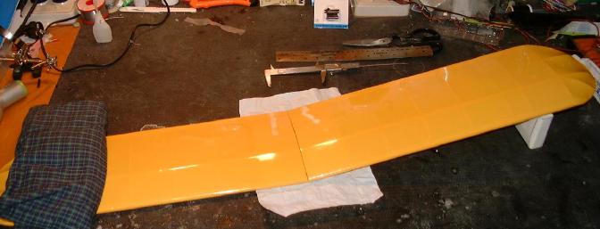

After gluing the panels together, I decided to tidy up the wing joint by wrapping a single layer of black tape around it.

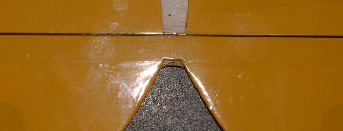

OOPS!
This is one of the few areas of the aircraft that I wasn't 100% happy with. The fit of the fin/rudder actually fouled the movement of the elevator. I ended up trimming a little out of the elevator to give some clearance, but in retrospect it would have been better to shorten the rudder tab where it inserts into the tail plane.

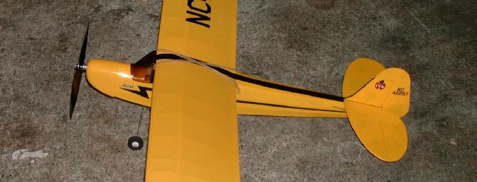

After installing all the electronics, there was very little left to be done. The addition of the canopy and cowling went without issue. The instructions indicated that the two holes in the cowling would need to be cut out, but on the review example this had already been done.
I affixed the decals, using the box photo as a guide. I also decided to extend the black trim theme from the wing centre, and ran a matching strip down the top of the fuselage. An added bonus from this was that I now had a very quick visual check that my wing was correctly fitted and centred!

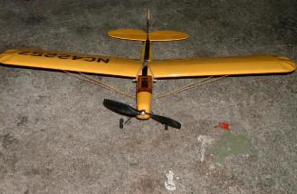

The final touch was to make up and fit the the simulated wing struts. These struts were simply yellow cord strung between ply mounting plates on the wings and fuselage. Although they provided no structural gain to the aircraft at all, along with the realistic decals they certainly helped to create 'the look' of a Piper Cub.

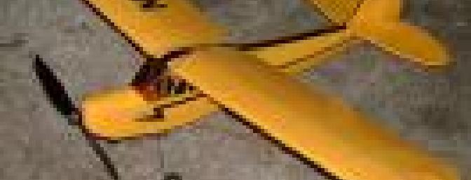

One look at the state of our strip (remember the weather I mentioned?) made the decision to hand launch easy. I ran the motor up to full power, gave Deane the nod, and with a gentle straight and level push we were off!
The little Cub left Deane's hands and flew away straight and true. The 280 motor in full song provided a healthy climb rate. There was no tendency to dip after leaving the hand launch, nor was the climb-out so steep as to get a newcomer into trouble.
Once I'd reached about 50ft altitude I made a gentle turn to the right. The Cub banked around nicely, with only a small amount of up elevator required to maintain altitude through the turn. Once I reached cruising altitude I found that I could throttle back to about 80% power and still maintain altitude and airspeed comfortably.
After cruising around for what seemed like forever (about 10 minutes according to the guys I was flying with) it was time to try a landing. Throttling back, I found that the Cub would keep flying right down to not much more than walking speed! I must admit that my landing skills were very rusty, but even my ham-handed approaches didn't phase the little Cub. I couldn't say that the plane is un-stallable, but I sure didn't find the limits despite being badly out of practice!
