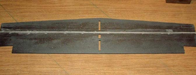

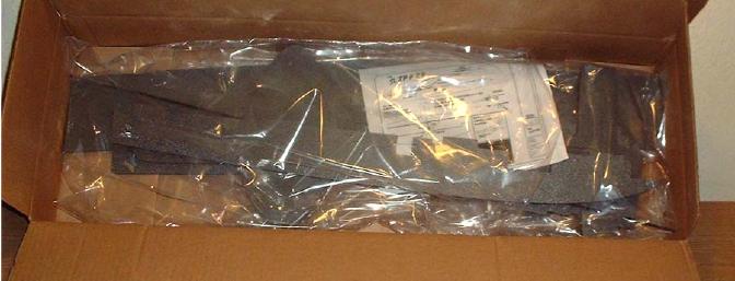

The instructions that came with Slipper II were for the original Slipper, but after a quick email I was able to download the preprodution instructions for this kit. I also found out that there will be two versions of the kit available. The first, like mine, will be the basic kit with only the depron parts. This kit would be good for the experienced modeler who prefers to do things their own way. The price for the basic kit will be very reasonable. After printing out and taping together tiled plans, then cutting out the parts from fanfold, the price for these nicely done depron parts seemed really reasonable! The second version will be a deluxe kit that will include all the hardware needed to complete the Slipper II.
These types of planes are not for the beginning builder or flyer although they are fairly easy to assemble. However, setting them up correctly and flying them is not easy and requires substantial experience. In light of this I won't bore you with a lot of text on construction. Instead I present a series of pictures with captions noting my style of setting up this kind of plane and any problems I encountered.
