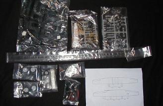

The first, most important thing for me to note is that I received this kit prior to full production. As such, there were no assembly instructions at all, I had to figure it out as I went along. That said, as with any GWS kit, it was very easy to assemble this model - the foam parts have molded locations for plastic parts that you simply cannot install incorrectly. If you've built any other GWS model, the parts will be familiar, and you too could probably build this model without referring to the instructions. The only tricky part is realizing that there will be many parts left over!
The kit I received contained all white foam parts - I believe this is how they will be provided in production - which made a great base for painting. The cowlings are vacuum formed plastic. There is the usual tube of GWS glue, which I tried to use wherever I could. Also included are a couple of familiar part trees - hardware I've seen and used on the Slow Stick and Formosa. There is a larger tree of black parts that I didn't recognize from other models, but after finishing assembly, I found I had a large number of leftover pieces on this tree, so It's probably shared across several models. Finally, the power system and undercarriage are in separate bags - 4 motors, with all associated prop adapters, props and spinners, and a collection of wheels and wheel mounting hardware. There are a lot of small parts in this kit, and I used a small fishing tackle organizer to store small parts like this during assembly.
The kit has a large number of parts, and I spent some time trial-fitting various components for photographs. After I had the bulk of the assembly process figured out, I decided it would be best to paint all of the major parts before permanently assembling any of these components. As a pre-production model, the assembly steps I describe for my model may not be representative of the final product. As such, I decided it would be acceptable for me to deviate from the design in a couple of areas, such as servo location and pushrod routing.

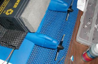

I started assembly by working on the props, motors and their mounts. I actually assembled the props prior to painting, so that I could paint those at the same time. The prop assembly was simple - I inserted the prop adapter into the prop, which was a tight press-fit, then added a washer and secured with a small nut. Two set screws held each adapter in place - a drop of oil here ensured they install cleanly. Then I pushed the spinner over the adapter, and was done. Now repeat three times... (You're going to hear this again.. trust me!)
The vacuum-formed cowlings needed to be trimmed along a line molded into the sides.
You can cut out the vent hole in the front, beneath the motor, for a more 'scale effect', then drill small holes in the pre-marked locations for the motor shaft and mounting screws. The motor then simply secured to the cowl with two tiny screws, then I slipped the prop in place and secure. Now repeat three times!
The motor pylons are molded foam, and have a small area above the wing that needs to be trimmed. I also drilled a hole through from the front to route the motor wires up to the wing. After securing a couple of small pieces of plastic to each side of this foam piece with GWS adhesive, I pre-drilled the cowl and plastic piece to allow a small retaining screw to hold the cowl in place.
Again, this needs to be repeated for all four motor assemblies, and when they were complete, I dabbed a little blue paint over the screws and the trimmed area above the wing. With the props installed, the motor assemblies looked great. I just had to hook them up and see how much current draw I could expect. We all know that's right. I really wanted to see how they sounded! You'll be able to hear for yourself in the video, below! Current draw, however, was about 6.5A peak on a 7.4V LiPo pack.

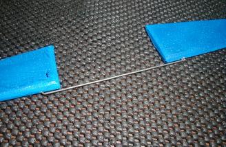

Following the suggestion of other RCGroups members, I hinged the control surfaces with pieces of floppy disk media. The production kit will contain the familiar GWS "CA-style" hinges, but mine did not, and I did not want to delay assembly. I performed some testing on scrap foam pieces to ensure this method would work reliably - using GWS adhesive, I installed a 1/4" strip into two chunks of foam. After leaving to cure overnight, I was unable to separate these parts or rip the hinge material, even with extensive tugging and twisting.
Using this technique, the control surface installation went quickly. I simply slotted each surface with a sharp blade (using extreme caution here!), applied a small amount of GWS adhesive to each side of the hinge material, and inserted into the slot.
I installed three pieces on each elevator half and the rudder, but four on each aileron. Then I lined up each surface with the appropriate part, and marked the slot locations. I cut those with the Exacto, apply adhesive, and carefully slid each control surface into position.
The elevator required installation of a provided U-wire - with the elevators spaced appropriately, I marked the position of this wire, drilled a couple of small holes, and using a dab of ProBond, installe the wire into the elevator halves. This made installation of the elevator tricky, but it still only took a few minutes. I then installed control horns on each part - I cut down the provided horns to only leave two holes, and then installed each with Elmers ProBond Polyurethane adhesive. The surfaces were thick enough that you could not use the provided control horn retainers (as used on the thin foam control surfaces of the GWS Slow Stick, for example), but I had confidence that ProBond would do the job! I also trimmed the aileron control horns so that they did not protrude through the top of the aileron. Also note that when using an expanding polyurethane adhesive, you need to put a little tape over the hole in each control horn location to prevent glue from leaking through. I then set all of these parts aside to let the glue cure overnight.

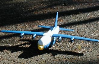

The location I chose for photographing the completed model is just a few miles from my home. I am quite fortunate to be able to utilize this for these photographs.
The GWS Cargotrans Quad is a fantastic replica of that well-loved transport, and produced in white foam, lends itself well to any color scheme the modeler chooses to reproduce. I hope readers who choose to build one will share their pictures here too! Although there are a great many parts to assemble, the process is simple enough that it can be easily accomplished by even the average modeler, even without instructions. The model flies well on the provided power system. You must provide your own battery and ESC, but the motors and props are adequate for even beyond-scale-like performance. The "wow-factor" is a big plus - there has been a lot of excitement surrounding the release of this model, and I believe it will be another huge success for GWS!
