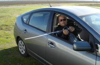

Speed
The first test was to determine the accuracy of the FDR's speed readings. For this test I taped the Pitot tube to a metal yardstick as shown in the picture below. The FDR is supposed to be able to measure speeds above 9 miles per hour up to 290 miles per hour. For this test I checked its accuracy on speeds from 10 miles per hour (MPH) to 60 miles per hour. With a friend holding the yardstick with the Pitot tube out the window of my car, I drove down a remote abandoned runway. I increased my speed in increments of approximately ten miles per hour. With the wind at our back I accelerated my car up to ten miles per hour then twenty and topped off at thirty four miles per hour. The car coasted to a stop and we turned around for our return run into the wind. The wind was blowing approximately 10 mile per hour. I accelerated the car up to forty MPH and after a few seconds accelerated up to 60 miles per hour. After completing the two test runs I went home and downloaded the data from the FDR using the supplied USB cable and my Compaq Presario computer.
The results were quite interesting. On the first trip with the wind at our backs there were a few glitch readings while I was still stopped, but once under way the readings were right on with my car's speedometer with a top speed of 34 MPH and then braking and a pause. On the return trip down the runway the readings into the wind were higher then my actual speed. When I was going 40 it recorded 48-52 and when I was going 60 the readings were from 66 to 74. The difference I attributed to the headwind I was driving into on the second test run. Thus the information on speed would be accurate in calm conditions or flying downwind but into the wind considerations of the wind's speed are necessary if ground speed is the desired measurement, as the wind added to the reading. I was very pleased with this result and that the FDR passed my first test. My thanks to Jeff Hunter for assisting me.

The author has a fundamental misunderstanding of the what airspeed really means. He confuses indicated airspeed with ground speed.

Re-read the article, he clearly states that the headwind accounts for the difference in his findings between the car's speedo and the data recorder's readout.

While doing a test in the car he said: "Thus the information on speed would be accurate in calm conditions or flying downwind but into the wind considerations of the wind's speed are necessary as the wind added to the reading."
He seems not to understand that driving downwind the speed of the wind will make the indicated airspeed less.
Later, when talking about a test in the air he said: "That speed was probably 86 miles per hour on a calm day or down wind but maybe only 76 MPH into a ten mile per hour wind."
Here he seems not to understand that the indicated airspeed of a plane in flight is affected at all whether the plane is going up or down wind.
Maybe you also don't understand fully?

Gentlemen:
I do understand the difference between airspeed and groundspreed. And I have experienced the benefit of a 100 mile plus tail wind in the jet stream. In the speed experiment I videotaped the speedometer in both runs and played it back in real time and noted the speed at different intervals on my stopwatch in viewing back the video. Those times were then compared with the FDR data readout on playback. On the down wind trip the speed recorded on the FDR matched up almost perfectly with the digital readout on my speedometer which has been checked for accuracy by doing a marked mile stretch at 60 miles per hour with cruise control on and taking 60 seconds (plus or minus one or two tenths of a second.) to run the mile. I was reporting ground speed readings from my cars speedometer and the FDR matched those (not higher or lower) going downwind. I only did one test run downwind and one into the wind. My FDR has been mailed back for diagnostic testing to see if I fried the altitude meter but when it is returned with the Seagull telemetry unit I will do further tests on speed and hope to include more test data and compare readings with a radar gun at the slope.
I hope you enjoyed the article. Mike

Mike,
The thing is, a pitot tube can ONLY be used to calculate AIRspeed - via comparing the static air pressure sensed wherever it is (on the FDR box itself, right?) and the dynamic pressure from the pitot tube.
So where you mention a "problem" because the airspeed reported into a headwind was higher than the groundspeed is not really a problem - it IS the AIRSPEED after all that the unit is measuring. It cannot measure ground speed.

Hi BEC:
From my experience pilots want to know how fast their plane is going compared to ground speed and not the airspeed that the device measures. The FDR does measure the airspeed in the unit itself and the Pitot tube connects to a nipple in the center of the unit. I created a possible misunderstanding in trying to keep my discussion on the matter short and I was not precise in my use of language. Mike

Mike,
Perhaps they do, but that requires some kind of measurement that can see the ground, which is beyond what the FDR can do. Besides, as is often argued in "downwind turn" discussions - the airplane cares rather more about airspeed than groundspeed regardless of what a ground-based pilot may care about. In other words, this unit is no replacement for a radar gun for those who want to know how fast their plane is relative to the ground.
In reading the manual on their site I can see that the static port is on the FDR box itself somewhere - they talk about making sure that there are no pressure fluctations inside the fuselage (such as from a cooling air intake) to mess up the static pressure sensing, and describe bringing a static line out to the side of the fuselage if needed (as is done in full scale practice).
