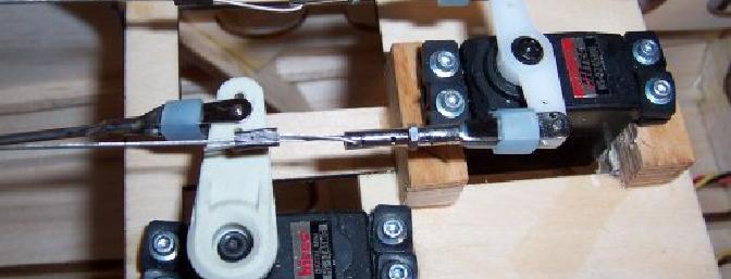

Radio Installation
No Tail Pushrod Cutouts In the Fuse
The fuse did not have any cutouts for the rudder pull-pull lines, and the book only showed a vague location. I couldn't put it too far back as there was a former there that would get in the way. The manual showed the lines crossed but I didn't see any reason they needed to be.
I made the dual pushrod for the elevator the way the instructions said to, but I used 2-56 rods, as the stock ones were a little too flimsy and flexed. The instructions didn't show where to cut the holes for the exits and they were not pre-cut in the fuse so I just guessed where they looked right and cut the exits just like the rudder ones.

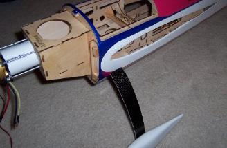

Landing Gear
There were 3 blind nuts in the fuse for the stock gear, and they did not line up with the holes in the gear. I wasn't sure why they were off so far, I'm sure it has been fixed in the current production models. The blind nuts also popped right out as they were not installed tight.
Warning!
Always wear a mask when sanding or cutting carbon fiber and wear protective clothing, as carbon fiber dust is very bad for you.
The stock landing gear was too short for the larger prop of the electric motor.
The manufacturer indicates they plan to have a taller gear available directly from them in the near future. It will be included in all kits sold after 12/1/04, and available upon request with proof of purchase for earlier kits. This is a REALLY impressive move on the manufacturer's part. Way to go, Fliton!
I could not find any premade carbon gear that were in stock so I had to make my own. I basically made a mold out of blue foam that was the right shape, then layered up the carbon and fiberglass layers in-between 2 pieces of mylar, then I put it in a vacuum bag over the mold. When dry, I cut it out on the band saw and shaped it the way I needed. It took some time and was very messy to make. http://www.fiber-lite.com has a set for the Funtana 90, the extra tall version. They were out of stock at the time of this writing. Theirs are close to the same size as mine are, just a tiny bit taller. If I could've gotten them, I would have had to cut them in half to install them. The size of the gear I made are 6 1/2" tall from axle to the top of the gear, 14" wide at the axles, and 5" across the top where they go to the fuse. Those dimensions left enough room to cut them in half then install each one in the fuse.
Motor Installation
Next I moved on to the motor installation. The extra torque of the electric motor with big prop would be harder on the mount than a glow engine, so I glassed the mount, even though it was built with interlocking parts. I was using the radial mount with the Axi 4130/16 outrunner and for it to match up to the front of the cowl a spacer was needed. I used a piece of 1 3/4 PVC pipe cut to the right length so I had about an 1/8" spinner gap and then used some 6/32 all thread rod and bolted it onto the blind nuts I installed in the firewall, and made sure to locktite everything. The distance from the firewall to the back of my spinner was 5". I was also using the Jeti Advanced 77 opto ESC, from Hobby-Lobby. I also used a Koolflightsystems UBEC to power the radio system from the main battery pack.
