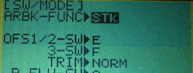

Switch Assignment as a separate FUNCTION?
Acro's version of the new added switch assignment screen looks odd at first glance. Why a whole separate screen simply to assign the switch that controls the crow/butterfly/airbrake function? But that question is easily answered by looking at the glider programming, as shown in the picture above....this new screen has added functionality for the glider model types and, we can hope, is an indication of Futaba's future mindset -- a single screen for users to make all switch assignments at once! (Hopefully they will give the user the option to assign switches BOTH within the function itself AND in a separate switch assignment screen, so that the user can make the assignment in whichever position feels more comfortable and, of course, each function screen and the switch assignment screen would automatically update -- AND GIVE WARNINGS FOR DUPLICATE ASSIGNMENTS.)
