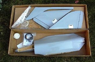

Enter the HET Skyray ARF, the subject of this review. HET is co-operating with the RBC company to bring us an ARF version of the classic RBC kit. Markos at www.Warbirds-RC.com is importing this almost ready to fly kit, and provided it along with a Mini-fan 480 for this E-Zone review. Since I only recently also built the full balsa construction kit version from RBC I will include pictures of both, commentary on differences if any and comparisons of weight and flying characteristics. Since the ARF is largely based on the construction kit presumably any difference will be minimal.
The kit arrived nicely packed in a plain brown box with “HET” High End Technology Skyray ARF printed on the box top. Opening the box revealed a two level packing system. The top layer contained two ready to fit covered wing panels, a rudder / fuselage top spine, plywood former to support the thrust cone and 2 wire pushrods. The airframe components were all tightly wrapped in poly bags and each of the parts was securely taped to the cardboard divider. Removing the divider revealed the remainder of the components – the fuselage again pre-covered, the poster board thrust tube already formed into a tube, and the bare balsa canopy frame loosely fitted into the un-cut unpainted canopy. The fuse and canopy assemblies were again wrapped in poly bags and taped in place. Additional hardware included were sheet metal screws, washers, tow hook, control horns, machine screws and clevises. The hardware was strewn throughout the box, sometimes trapped in place by tape securing other items in place. In my opinion the one packaging improvement needed would be to place the hardware in a bag rather than just throwing it in the box.

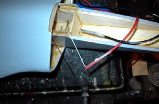

I chose to install my receiver in the rear of the fuselage. The factory provided pull strings to route servo wires from the back to the front as well as power wires for the ESC. Since my receiver was going in the rear I removed the red strings which went from the wing root area to the cockpit. The white strings in the center section on each side of the fan were used to pull a 13 gauge power wire on each side. When doing this be advised that the holes are not overly large. I taped the power wire to the string with thin scotch tape then clipped the end of the wire at 45 degrees, to help it self guide through each hole as I pulled from the rear.

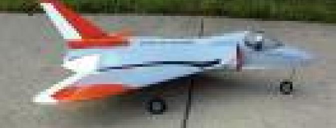

A couple of times a year I go to events with paved runways and having landing gear on the Skyray would be a big plus. I made my gear from a Dubro antenna mount drilled out to accept a 3/32” wire leg for the nose gear. For the mains I used bits of ply, balsa and maple to make mounting blocks which accept 3/32” bent wire legs. The wheels are a 1.5” Hangar 9 Prolite on the nose and 1.75” on the mains. Nose steering was initially a Hitec HS-50 but the gears in this proved insufficient so it was replaced by an HS-81 metal geared servo.
