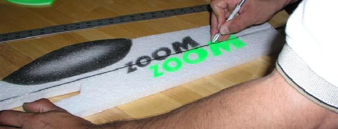

I joined the wing panels together using hot melt glue. I used hot melt glue because of my past experience building with epp foam. Hot melt glue on epp, if used sparingly to watch the weight, gives one of the strongest bonds Ive seen; it also flexes with the foam, and dries in seconds.
Next I used a straight edge to cut a slit across the wing to accommodate the spar. I deviated from the instructions here and used a flat carbon fiber spar installed perpendicular in the wing rather than the thin aluminum rods supplied with the kit. The carbon spar is very strong but let me stress here this is a personal preference and not a must do.
When using the stock aluminum rods, it is important that you make sure you scuff the rod first for good adhesion, then glue the entire length of the rod using foam safe CA. If the rod is properly glued its entire length, the foam will be very rigid and bending is almost impossible.
