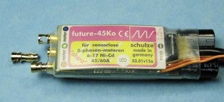

Speed control of the month: schulze future-45Ko sensorless brushless controller
I think the first time I heard of sensorless brushless controllers, the ones I heard about were schulze units. In addition to their world-class chargers, schulze have been leaders in introducing sensorless controllers for brushless motors. Being pioneers means, among other things, that they've had time to refine and improve their product several times. In their current sensorless line, the futures, they are up to version 15 of the software. By the way, schulze is the only ESC maker that actually tells you what the software version is on the label. They have also added a number of selectable modes to cover a very wide range of motors and applications.
As I wrote in the September 2001 column, one of the challenges to sensorless brushless systems is that the controller has to infer the motor's rotor position from just a little motion in order to properly start the motor. It also has control over the motor's timing. With the large variety of motors out there with two poles, four poles, and six poles (at least) in their rotors, as well as different construction approaches that respond differently to timing, it is a real challenge to make a sensorless controller that can cope with that wide variety. The schulze futures, with the "super high performance algorithm" or "SHPA" go a long way toward being able to run most any brushless motor. I have driven several very different motors, from Aveox, Jeti, and Hacker with my future-45Ko and it starts and runs all of them reliably and with only an occasional hesitation. It seems to help to go immediately to about 1/4 throttle stick, rather than to trying to ease on power.
The family of sensorless controllers includes, at last count, 32 different models for sport/aerobatic/scale airplanes, FAI competition, pylon racing, helicopters, cars, and boats! The future-45Ko is a sport/aerobatic/scale airplane controller rated for 45 Amps of continuous current, and is opto-coupled for lower RF noise, which also means no battery eliminator circuit (BEC). It is rated for 6-17 cells. Even though it has no BEC, it does have a low voltage cutoff (LVC) function, as many non-BEC controllers do, which is a self-protective measure. The LVC here prevents the voltage going to the microprocessor in the ESC from going too low and "crashing the computer" with unpredictable results. The LVC cuts off at about 5.6V. However, it can be immediately reset by bringing the throttle back to "off", and then advancing it.
The "-Ko" variant also has a "finned" heat sink on it, so that it can be run at part throttle constantly without overheating from MOSFET switching losses. This is more of an issue in brushless controllers, because they never get into a state where the MOSFETS are just turned on and left there as with a brushed motor controller at full throttle. A brushless controller is always switching the three coils of the stator of the motor on and off. Even so, brushless controllers also heat up more at part throttle than at full throttle. The big heat sink on the "-Ko" members of the future family keep them quite cool, even with extended part throttle operation. The heat sink only adds about 1/4 inch in thickness and perhaps 1/10 ounce (~3g) in weight, so is well worth it.
The back of the future-45Ko, showing the large heat sink

Physically the future-45Ko is fairly compact for a brushless controller at about 2.9 X 1 X 0.6 inches and it weighs only 1.5 ounces, ready to use. However, that weight includes no motor-side wiring as the future-45, like many schulze controllers, has 3.5mm female gold bullet connectors attached directly to the board. The mating plugs are supplied with the unit and installed in the sockets.
The future comes with 3.5mm gold bullet connectors for the motor installed in the onboard sockets. Here one is shown removed.

On the test stand, the future-45Ko behaves very well. Startup is generally smooth and with V15 software, the minimum motor power (which used to be an issue with sensorless controllers) is less than 2% of full. The throttle curve is fairly linear with RPM and smooth from bottom to top. But, being linear, most of the effective throttle range is in the upper end of the throttle throw. Response is damped a little bit, but only enough to make it feel very smooth in the air.
In two of the three brake modes, it is self-adjusting for both endpoints (and consequently the range). In the default "brake on" mode, the initial throttle stick position is taken as "brake", and the full throttle point is set when you advance the stick to full throttle the first time. When power is first applied, the future-45Ko will indicate the timing mode it is in with the appropriate number of beeps (e.g. four beeps for Mode 4), followed by a single beep two seconds later. Advance the throttle after this single beep to full throttle to set the high point. The motor will hesitate just a bit to let you know the upper end has been set. The brake comes on hard and quickly when the stick is returned to the low point in this mode.
The "brake off" mode is selected by powering up with the throttle stick high. As soon as power is applied, the system will beep to indicate which timing mode as described above. Two seconds later, it will beep twice more, indicating selection of "brake off" mode. This also sets the full throttle point. The "brake off" is then set by bringing the stick down to the bottom. The controller will beep the motor once to tell you it is armed.
"Belt drive" mode is selected by powering up with the throttle stick in the middle of the range (pulse duration between 1.4 and 1.67 ms). Again, the timing mode is indicated by the appropriate number of beeps, followed in two seconds by three more beeps, which indicates belt drive mode. You then can select the brake to be off by advancing the stick and holding until you get two more beeps. Next, pull the throttle stick to the low point to set the start point. The system will beep once to tell you "I'm now armed". From here, a fixed range of 0.6 ms takes you to full power. If you want the brake to be enabled, just pull the stick to the off point after the three-beep indication. The unit will beep once and be armed with a fixed throttle range of 0.6 ms.
In belt drive mode, throttle response is slowed down, especially the initial run up to full power. Also, the brake comes on more softly than in the default brake mode.
I find this mode programming every time you power the system up to be a bit too much to remember, as I mentioned above in the general brake disabling discussion. But, it does allow the maximum of flexibility in use.
Shutdown with a loss of signal is decisive after a brief delay during which there may be a brief burst of increased throttle. The brake engages or not depending on which mode you selected upon power up.
For flight tests, the future-45Ko went into my workhorse LT-25 behind an Aveox 1114/4Y on a 3.6:1 Modelair-Tech H-500 belt drive. Power is 10 cells of various types and my current prop of choice is the 14X7 APC thin E-prop. This combination draws in the upper 30 A range at full throttle.
First, though, I had to complete a range check. This airplane has a Hitec Super-slim receiver in it, and it is commanded by a Multiplex Cockpit MM transmitter. The receiver is at the back of the cabin, above, and behind the entire power system. On the ground, range checks showed only a moderate decrease in range with the motor running slowly as with it off - a good performance.
In the air, the future-45Ko behaves just as the bench tests would indicate - very well indeed. Startup is reliable and fairly smooth. The modulation of power is without surprises throughout the throttle range. Because it is a linear throttle, most of the usable stick travel is in the upper half of the stick's motion. The controller is cool to the touch after 8+ minute flights of mixed aerobatics, cruising around, and shooting touch and goes. The heat sink clearly does its job well.
Landings with the prop turning over slowly to provide a little extra drag are easy to do. I should note this was not so easy with an earlier software version, where the minimum input power was over 10%. At that setting my LT-25 simply would not land. Now, with the super high performance algorithm or "SHPA", this has been cut to less than 2% and landings with the prop just ticking over are simple.
The only problem, really, comes when I power up the plane with the throttle stick low as is my habit, then take off. This leaves the brake on and I usually remember that only when I pull the throttle all off the first time in the flight and I hear a loud "clunk" from the plane as that big prop suddenly stops. I keep worrying that I'm going to damage the belt, though so far it has held up well. As I've remarked before, if all of the controllers you have are those that require you to power up with the stick high to disable the brake, then you probably won't have this problem. But for me, well, maybe it's the beginnings of old age setting in...
Overall, I like the future-45Ko and look forward to using it in an application that uses more of its capabilities.
