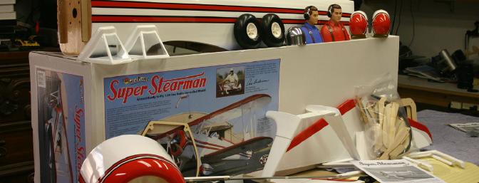

All the major sub-assemblies are packaged in clear plastic bags, with lots of clear tape holding them in place. My plastic windscreen assemblies arrived intact. It takes almost as long to remove the packing materials as it does to assemble the kit!
I ran an inventory of the parts in the box against the parts list and found that the small jig blocks used to set dihedral were included, but not listed. Everything else on the list was in the box. (Interested in viewing the manual while you're waiting for your ordered kit to arrive? Just go to the Great Planes manuals page and download it!)

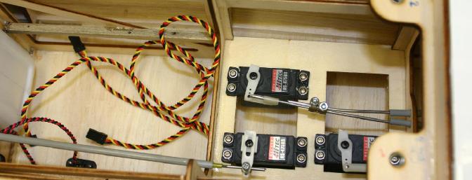

I chose to use the four aileron servo option, but at the time of initial assembly, the servos had not arrived. I always make up my own extension leads using #22 Teflon covered stranded wires that are soldered to the servo leads and twisted. This way, I can eliminate the use of any unnecessary connectors and the leads are made exactly the right length with no excess. I also use locking connectors with gold plated pins. Using a spare servo as a template, I made the pushrods and control horns. There is an option to use only 2 aileron servos with interconnecting links between the ailerons, and all parts and instructions are in the kit if you choose to go this route.

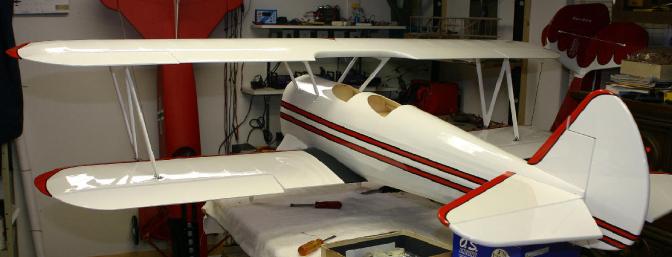

The main landing gear and belly pan were added and the holes cut for the tail pieces, using that hot soldering iron.
It was absolutely perfect as supplied in the kit, with no sanding or fitting required. Rather than use epoxy, which can get a bit messy, I used thin Zap to attach the stab to the fuselage, especially with such a wide gluing surface inside the fuselage. It will wick into the joint, but care must be taken to avoid dribbles caused by too much CA. (Don’t ask…)
The fin was added next, followed by the elevator halves, the rudder and tail wheel assembly. The tail wheel wire is loosely supported by the lower hinge, but mostly by the rudder.

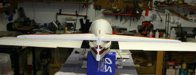

The upper wing is held in place using bolted-on tabs that connect the interplane struts to the wing panel. The position of the fuselage cabane mounting screws was made by using the N struts to hold the wing in position and making sure the upper wing is parallel to the lower wing. The fuselage with the wings attached was placed on its nose and the two wings checked for relative location. The fuselage holes were drilled and the screws installed, making sure the screws go into the hardwood supports rather than the balsa fuselage sides. Mine fit quite well. Be sure to remove these screws and harden the screw threads in the wood with thin ZAP.
The interplane strut tabs were attached to the wing with Allen head bolts and the interplane struts were attached to the brackets with Phillips head bolts and safety nuts. I am planning to use longer Allen head bolts since the ½” long bolts supplied only engage 3 or 4 threads on the blind nuts in the wings. These will be removed and replaced when assembling or disassembling the plane, and a little extra length will be worthwhile.

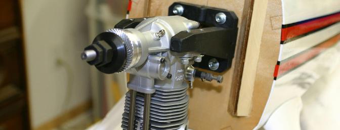

The throttle servo and pushrod were installed and I came to one of the harder parts of the assembly process, the installation of the cowl. There’s a plywood ring that was attached with bolts to tabs on the fuselage. The design made the bolts accessible from the rear of the cowl for easy removal. Using the engine for centering, the cowl was trimmed for cylinder head clearance and placed over the cowl ring. Once it is in place, it was tack-glued to the cowl, removed and fixed into final position using Pacer Fiber-Poxy. Holes for the muffler exit were cut in the cowl.

With the Hitec HS-475 ball bearing servos available at the work shop, I installed them in the upper and lower wing. The aileron push rods were cut to size and installed along with the plastic control horns. Extension cords were made up and pulled though the wing panels using the pieces of string that Great Planes thoughtfully added there when they initially assembled the wings. The servo wire exit holes on the top wing were near the center of the completed panel, making the location of the servo wire difficult to locate without being noticed. I relocated the exit hole near a cabane strut and will make arrangements to secure the wire during flight.

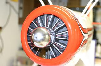

The Stearman kit came with a nice polished dome type spinner, similar to the ones used on the full size Super Stearmans, and I installed it using the supplied mounting kit. The spinner prop slots needed to be cut larger to allow the use of an APC 18-6 wide blade prop, and rather than mess up a perfectly good spinner, I ordered a new AT-6 style dome spinner from my friends at Tru-Turn. It was cut especially for this particular engine and prop combination and it was a simple bolt-on installation.

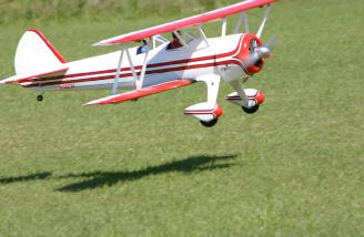

A slight breeze was blowing from right to left, and I pointed the Stearman’s nose into what little breeze there was. With a bit of power applied, it accelerated smoothly, with the tail lifting almost immediately. A bit more power and the plane lifted off the ground smoothly and steadily. It was climbing a bit more than I really wanted it to at this point, so a few clicks of down trim were added. Once a full circuit of the field was made, the Stearman was flying hands-off at half throttle. I increased power to full, but the engine seemed to be a little on the rich side, meaning this was all the speed I was going to have available at the present time. I took the Stearman to altitude, cut the power to idle and added full up elevator, which resulted in a dip of the nose and the resumption of straight and level flight. (The IDEAL stall!) A few loops and rolls were done, but the best maneuvers were the stall turns and the huge barrel rolls. This is how a Stearman is supposed to fly. I made several photo passes for the camera, and set up a landing. Power off, the Stearman just glided to the left end of the grass runway and with just a touch of up elevator, it settled down to a one bounce landing.
I checked everything and found that one of the swing keepers had popped loose from a top aileron. I must have loosened it when attaching one of the interplane struts, since they are close to one another. I just happened to have a spare in the parts box, and it was time to fly again.

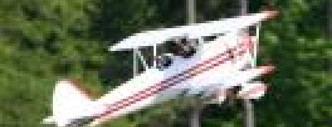

The second take off was a little faster, since I had leaned the engine a bit. More low passes and mild aerobatics were done, including a sliding flat turn. The full scale Super Stearman, although powered by a 450 HP engine, was not an all-out aerobatic aircraft. Sure, it would loop and roll, but not like the aerobatics that are done by CAPs and Extras. Stearman aerobatics are slow and graceful, smooth and steady; just like the Great Planes Super Stearman is capable of doing.
The third flight of the day was even more enthusiastic, including an attempt at a knife edge and some inverted flights. Well one out of two isn’t bad. The Stearman would not hold a decent knife edge at all, just like a full size Stearman.
I decided to check the engine RPM, finding it was turning the prop at about 7200 RPM, fine for normal flight, but a little more speed might be necessary to perform some of the more enthusiastic maneuvers.
