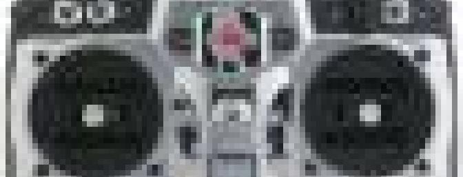

Comparing to 9C
Outward appearances
Standing side-by-side, the 2 radios certainly look a lot alike! Their lines and shapes are complimentary, with the 7C sporting a more silver finish than the 9C's unique champaign coloration. Those wanting the 9Cs ease of use will be thrilled to see the same button and dial setup!
Differences:
  • 7C has no campac port for added model storage (see photo above).
  • 7C has 6 switches and 1 dial vs 9Cs 8 switches, 3 dials and 2 sliders.
  • 7C has a molded plastic handle vs. 9Cs mounted metal finish handle.
  • 7C uses a simple crystal for frequency, vs. 9C's module system.
