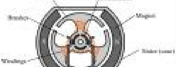

What Is A Brushed DC Motor?
The motors we are referring to consist of very few parts.
The Stator: In most cases, it is the outer housing of the motor. It is made of a soft (does not remain magnetized) magnetic material, most commonly iron and contains magnets that are arranged to have one north and one south pole. There are also two bearings, either plain plastic or porous brass bushes or (in more expensive motors) ball bearings.
The Rotor: This either consists of an iron core carrying sets of windings (called poles) or is coreless. In the latter case, the windings are wound by a machine and then fixed by resin such that they stand alone without the iron core. The number of poles is most commonly three, and sometimes (in better motors) five. More poles tend to be used only with bigger motors that are too large for small indoor models.
The Commutator: This consists of two halves; one-half fixed to the rotor, the other to the stator. Its purpose is to route the current from the motor terminals to the rotor windings and switch the current in such a way that the windings of the poles generate magnetic forces that cause the rotor to turn indefinitely. This is the part of the brushed DC motor that makes it brushed. It is the brushes that connect the rotating rotor to the stationary stator.
