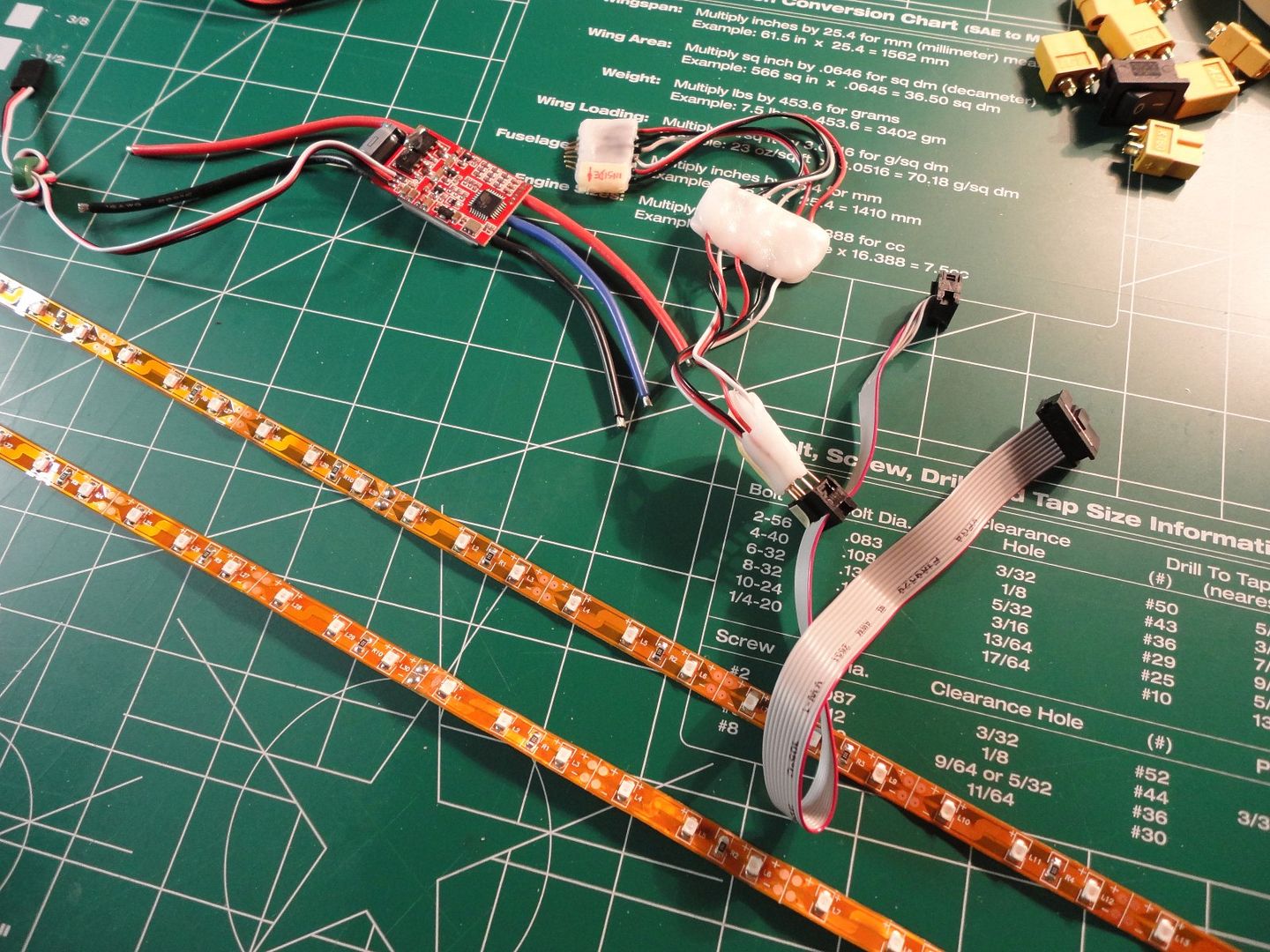

Yes, you can flash the ESC's yourself. HERE's a decent video on how to do it.
I built my own pin adapter using the cable that comes with the ASPusb cable, some InstaMorph, and some extra wire and lead pins.
