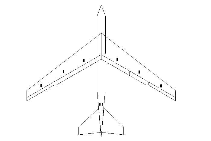

I am going to be using two receivers and two batteries on my 11 foot B-52. First reason is safety. The second reason is to handle the load of 10 servos. There will be three servos per wing working as flaperons. There will be two servos for the elevators. One servo for the bomb-bay doors and one servo for the bomb drop mechanism.
Any opinions on how to split the servo assignments between the two receivers? I have an idea how to do it, but I want to harness other brains out there to imagine failure modes that I have not considered.

Perhaps this will help:
Each wing has three control surfaces. Only two channels are needed to drive them, using flaperon mixing and allowing for crow. So the servos are hooked up with Y connectors. The reason there are three surfaces per side is due to the way the wing constructed and the way it comes apart for transport. It also allows for spreading the load around to more servos.
The elevator halves are mechanically independent, but only commanded by one channel.
If any one servo fails, the plane can still be flown. By using two receivers, I hope to still maintain some degree of control if one receiver were to fail. I realize this won’t offer much in terms of glitch control or bad piloting, but what I am trying to protect against are some of the most common equipment related crash causes, such as a failed servo, battery failure or receiver failure (such as when the crystal goes bad). I know these are rare events, but I have lost a power plane to a tooth breaking off the elevator servo, so I know they do happen. Considering the size and weight of this plane, not to mention the time and money invested, I think it wise to add what redundancy I can.
Splitting the servo assignments to right and left halves is one way of doing this. It could also be done by having the outer aileron servos assigned to receiver A and the middle servos assigned to receiver B, etc.

Going backwards a little, back to the Y cables.. I believe the issue of having multiple servos in parallel is that the power consumption may be more than the receiver is designed to handle. Of course voltage sags under load, etc.. may come into play as well.
I guess if you really wanted to have the redundant servos, there are tow potential ways of doing it. The first is to split the load, but I wouldn't go right and left with it, it would be very hard to fly if one receiver was doing whatever it want on the left side, and all you can control is the right side. I would think your chances would be better if one receiver was inboard controls, the other was outboard controls. This way, you may have a chance to override the failed receiver.
Another option, which would be tough, but workable..... Dedicate one channel per receiver for a gang of switches. Basically, you would try to allow either receiver to override complete control of the other reciever. So, for example, you could have the outputs from each receiver go into a set of switches (let's say receiver A and B). Then, Ch8 from rcvr A directs the switch, and Ch9 from rcvr B directs the switch.
Now you fly rcvr A as a primary. If there is a problem, you turn Ch9 high to force all the servos to switch over to the output from rcvr B.
I think this could be done with a bank of switches in a chip, as you would only be dealing with the signals. You could then add a small SSR to also flip power to a reserve batt.
The next level would be to rape the circuitry from a Lost Model Alarm, and tie it's audio output into the switch, you coudl then theoritacally have the LMA monitor the frames from the primary rcvr (rcvrA), and if a dropped frame is detected, have it force the switch automatically.
You could also create an automatic switch if you are using PCM radios, you could have one reciever default on LOS to push one channel high and activate the switch. I guess you would then want to add a flip-flop to make sure it didn't default back.. I guess this wouldn't work though, because the PCM is only going to Lockout if it losses the tx signal, and in that case you are kinda hosed anyway..
Of course, now you have to ask yourself if you trust your transmitter. Should you keep a backup Tx on hand as well?
Anyway, just thinking outloud..
lemme know if you are going to want to tackle the switching method. I might be interested in trying to design something to do that..

In full size commercail planes the redundecy is split so that you would still have symmetrical control after a failure......ie rudder on one system ailerons on the other (And/or inbd ailerons and otbd on seperate systems) spoilers split so that any failure still leaves some on each wing working and so on.....With 4 or 5 hydraulic systems...you end up with 5 different ways to turn the airplane. (as long as you don't lose all your hydraulic fluid that is can any one say "Sioux City"..ouch!)
anyway that sort of philosophy of redundecy may be what your looking for??

Yes, those are the kind of thoughts I am looking for. How to split the functions between the receivers for best redundancy in case of failure.
