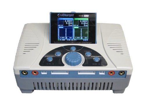

It looks like a 1990's game console !!!!!! Why did it have to look like that !
Still, an interesting addition to the iCharger lineup.
First thing that came to mind when I saw that pic was Nintendo
