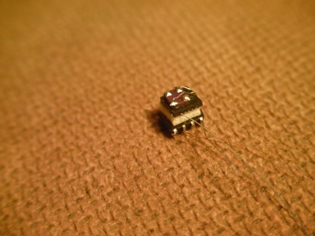

seeing thierys success i decided to give my 2nd deadbug, which was a little too dead, another look. it was a mystery why the first one worked but my second didnt (new years resolution: dont take apart the orginal until the copy is up and running). finally figured out what was wrong. good thing too because it was one of the reasons neither of my prototypes worked with certain radios. turns out this particular implementation is very sensitive to adjacent channel crosstalk and the rx must be initialized some distance from the tx. specially ones with powerful output like the 9x or t6. i noticed all the prototypes worked with a low power aliexpress module plugged into the tx but failed with higher power stock modules. sure enough putting a few meters between them gave 100% success.
so heres some photos added of the latest deadbug unit. 150 MILLIGRAMS! this has to be a world record for lightest rx. certainly a flysky compatible. about half the weight of popular deltang spektrum compatible units. now those with turnigy, syma, wlt, etc radios can get in on the lrf or parkflyer fun!

photos for the tiny ppm version of diy flysky rx have been added below. construction steps:
1. collect parts and bend pins of the soic around onto the belly to form a plcc. be careful because you only get one chance. pins will break off if bent up instead of down or bent more than one time. since the original part number and pin 1 mark side ends up glued to the module and no longer visible i like to scratch a new pin 1 mark on the bottom to minimize losing track during wiring.
2. glue avr tiny chip face down to back of xl7105 module. ca works good. the pin 1 edge of the chip should be away from the pin 1 edge of the module where most wires will go. this is also a good time to tin the pins which facilitates soldering.
3. form and tack on the 1n914 diode with cathode (band) going to pin 2 of module (3.6v vcc) and anode to pin 8 (4.1v b+) of the chip.
4. add .1mfd cap between anode side of diode to pin 4 (gnd) of the tiny.
5. solder a ground wire from the vias under the a7105 ic on the module to pin 4 of the chip. since none of the wires cross over i prefer using single strands from ribbon cable instead of insulated for this. convenient because its already tinned. then the other 4 wires to the edge of the module.
DONE! one thing i should mention is use super thin wire (42 gauge or smaller) else theres danger of pins breaking off. VERY hard to repair.

Originally Posted by midelic View Post
Please, put a diagram and code......I know you are warm an fuzzy like a teddy bear.
oh yeahhhhh... they call me dave"teddybear"1993 cuz i never scold or make fun of people. muahhhhhahahahahahah!
ok. so ill see what i can put together when i get back home this weekend. im sure anything i do wont be as good as thierys excellent project in the other thread. however avr and tools are a little more accessable and friendly so there may be some benefit there. ppm might be a ways off yet because im not active in the software end atm. what i got is doing the trick for me. failsafe was the last thing on my todo list. ive got 8ch mega8 code ready to go which will be a good start. i was basically working from amicom reference design so will need to hack together a schematic. you might not even need one yet because you can make out wiring in my proto photo. thanks for showing interest guys.

Excellent look forward to it sure it will take a month for all kit to be in one spot.
Atmega 8 be great, turns out qfn 85/2313/8 all the same foot print.

Dave,
How about the smallest flysky Tx mdule, "diy flysky/turnigy tx" with A7105.It will be great addition to core9x.

great minds think alike. as mentioned a while back:
Originally Posted by dave1993 View Post
in the turnigy thread i have some really tiny joysticks and just built what has to be the worlds smallest radio. literally 1" with 8 channels and of course er9x. even the small breakout board was too big for this one so im back to tacking things onto a bare m128 again.
that includes one of the milligram a7105 units. this time programmed as tx instead of rx. obviously no other way to get this small. first i have some hex files for this diy rx thread that ive been carrying around on an sd card all weekend. when i get a chance will pick and put one up in post #1. along with some construction details and info on linking to a 9x or v911 transmitter. hopefully this afternoon. anyway virtually identical to the one in the prototype photo here which does show signals and how its wired so you already have a little jump on it.
