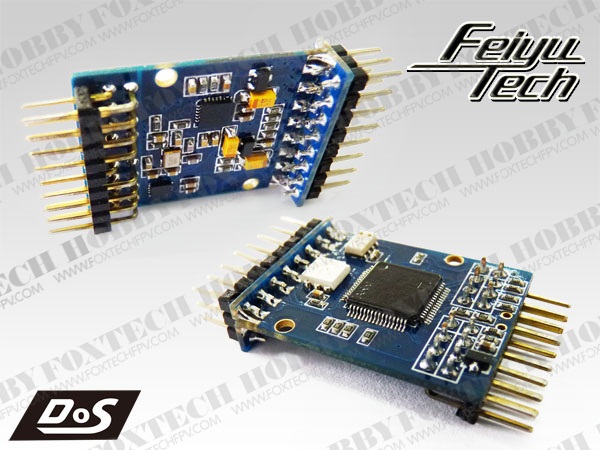

Hi guys,
Maybe you know if FY DOS have standard set of sensors: MPU6050, HMC5883L, MS5611-01BA01
In this picture it seems so but there is also unrecognisable white chip.
Kristaps

Is this the barometer?

White chip near edge with 2 holes is MS5611 barometer I don't know what is the bigger white chip closer to MC.
I also would like to see if DOS recovers plane from crazy situation like upside down ...
I am thinking of buying DOS without GPS and using other GPS module. Also want to try connect DIY OSD to telemetry port to have info from DOS on OSD.
