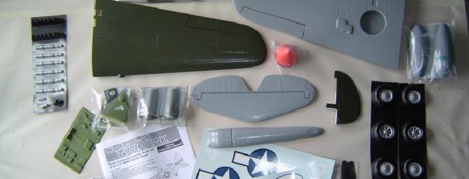

Upon opening the box, it quickly became apparent that most of the major work had been done for me at the factory. Things such as the fuselage halves being joined, wings assembled, and even control surfaces hinged were already finished! This drastically cut down on the assembly time, leaving only what could best be defined as “finishing” to do. I was quickly blown away by the raw detail in this kit. Panel lines, rivets, door outlines and the like are all pre-molded onto the foam. After a quick scan through the instructions, I was ready to get started. Construction looked to be rather straightforward right from the start. The instructions include plenty of diagrams and are perfectly adequate for kit construction.

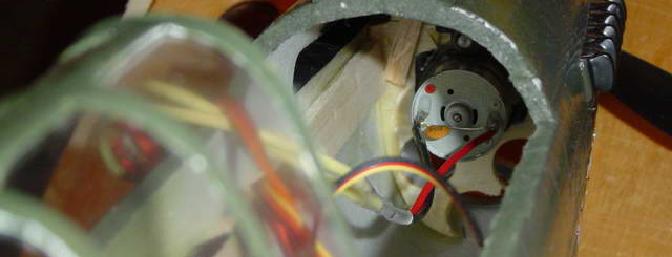

The radio gear all sits within relatively easy access through at hatch underneath the canopy. The receiver ended up sitting to the side of the fuselage just forward of the servos. The servos themselves sit in holes through the top of the wing, re-enforced with ply doublers. The pushrod guide for the elevator comes pre-installed for me. All I had to do was string in the pushrod itself and terminate it on either end.
My radio gear was kindly supplied for this review by www.hobby-lobby.com and consists of a Hitec Focus III SS with a 555 receiver and HS55 servos. Hobby Lobby also supplied a Jeti JES110 ESC to power the system.
Also supplied for this review was a Lightenna from www.eflightproducts.com . This antenna on the 555 receiver has proven to provide flawless performance. I have, in fact, yet to see a single glitch or interference hit with this setup.
As it turns out, the battery ended up in precisely the spot the instructions said it should. As I plan to fly this with more than just the one supplied NiMH pack, I left myself a small strip of Velcro to allow for some pack movement rather than a set box location. This was my own prerogative and neither adds nor detracts from the kit itself.

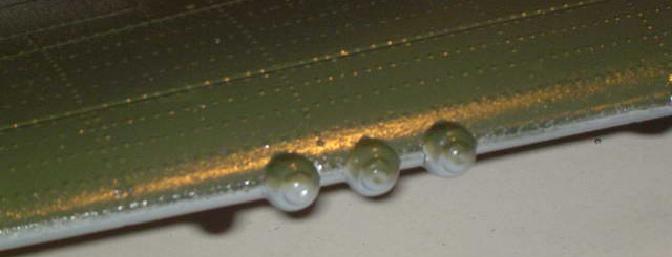

Plastic Scale Details
Preparing the plastic scale details was, for me, the most time consuming part of kit construction. They are all pre-painted but come in sheets of parts, requiring cutting out and trimming. Something that should be pointed out here is that included in this kit was a set of touchup paints. This was invaluable to me. In particular, I found the canopy frame needed to be touched up heavily after I had cut it out. I was quite impressed in that the touchup paint, once applied, is 100% invisible as to being added overtop of the base color. It not only matches but blends into itself beautifully.
