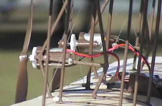

On the first day with each flight the motors initially sounded powerful but they quickly lost power. I suspected that the battery was not yet willing to work fully and needed some more break-in running. Although I had previously cycled the battery three times, all three battery runs had been with relatively slow power discharges. Also, I had charged the battery on Friday night and didn't get to fly until Sunday afternoon. My solution was to run the plane's motors on the bench for the rest of the existing charge and fluctuate the speed from full speed to half speed. Recharge the battery and do this a couple of times more before I tried to fly again. I was able to tell by the motor sound alone that this was correcting my problem. While I wasn't happy about the shortness of my first three test flights or the damage at the end of the third landing...in retrospect it seemed sort of fitting for a Wright Flyer. But unlike the Wright's first plane mine would fly again.
Per the picture below right the motors on my plane came mounted with full down thrust. This proved to be a good position for the motors and is the position of the motors in all of the clips in the attached video. The motors can be adjusted to a slightly more level position and control and flight response remains good.

During the course of these last bench tests the torque on the right motor caused it to twist in toward the fuselage and the right propeller hit the back of the fuselage and back of the foam wing. To stop this I added a paper shim between the motor and the motor mount and this corrected the problem. The paper shim, the nick in the propeller and the minor damage to the back of the foam wing can be seen in the picture below right.
Only after I had completed the above review and all pictures were taken for this article did I go a little crazy and abuse my Wright Flyer with any attempts at aerobatics. This plane is not intended for aerobatics but some of you are going to try them so I thought I would report on how the plane does. These were attempted with a fresh Nimh battery pack just off the charger. I climbed to altitude and did a reasonable dive and pulled full up elevator to attempt a loop and I failed to finish it. During the climb the plane stalled and the nose dropped. Recovery was easy but I was not able in a couple of attempts to get it to loop. Doubting any chance of success with a roll I again climbed to altitude and did a slight dive above the field at full throttle and got it into a slight climb and attempted a roll. I stalled and did sort of a half roll with a corkscrew downward finish. I corrected and climbed back to altitude and attempted to do it again with a slightly longer dive and started the roll as soon as it turned up. This time I completed the roll but it was rather ugly in my opinion. I have tried acrobatics and for my taste, I am done with them with the Flyer as they just don't look right.

i overcame the prop torque with a 37 cm line of spectra kite line looped around each motor strut and anchored at the knotched strut points.
its pretty obvious that the right motor torques inward more and pushes the flyer left.
at an indoor fly in, i tried a rog and it just whizzed around to the left.
