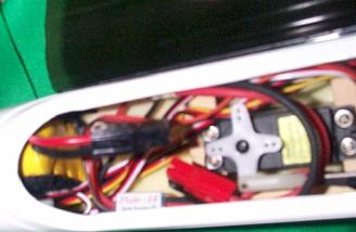

Radio Equipment
The servo installation has already been covered in the stabilizer and fin portions ofthis review, but here's how I installed the receiver and battery pack. There's notmuch unusual about my receiver installation - I simply used Velcro hook and loop materialto place it behind the rudder servo. My battery pack installation is a littledifferent, however. I started with a standard 600 mAh receiver pack in the nose, butI found the CG to be a little aft of the recommended spot (current notes on the Dynafliteweb site now give a CG range that would have been acceptable, but the instructions justsaid to place the CG 3 3/4 inches behind the leading edge), and I was uncertain about thequality of this pack anyway. So, borrowing from my electric power experience, Iplaced a 7-cell 1300 mAh NiMH flight pack in the nose and ran it through a CastleCreations Pixie 14 speed control, using the BEC capability to provide the correct voltageto the receiver. This pack fit the contours of the nose well (I used Velcro to holdit in place), and I can fast charge it before flying. Plus, the capacity is doublemy normal flight packs (just in case I catch a really great thermal!). This is asomewhat more expensive way to do things, but if you happen to have unused flight packsand speed controls laying around, it's not a bad way to make use of them.
As a side note, I made good use of left over equipment with thisproject. The transmitter, receiver, rudder servo, and battery pack all came from adefunct Hobbico Aero Cruiser!

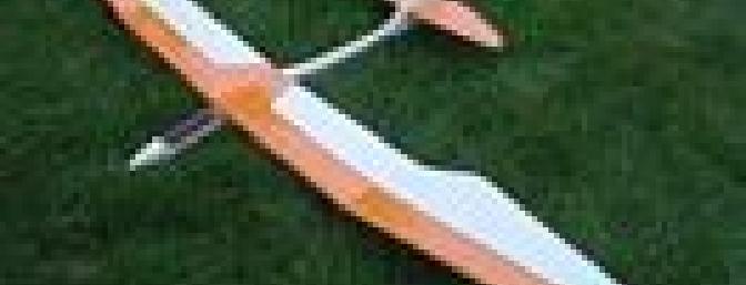

All Done!
Here's what Dynaflite's Bird of Time ARF looks like when complete. Avery beautiful ship!
This is a big plane! My son, who's over 6 ft, 1 inch tall is holding the Bird of time in the above photo. That nearly 10 feet of wingspan stretches out a long way!
