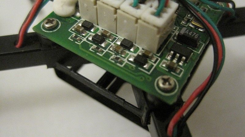

hmm. This is what I did:
- The motors are plugged into 4 ports (corresponding to motor #1 through #4).
- The Motor connected to the left most port (say port 1) stopped working.
- I disconnected motor #1 and connected it to port #2 and motor #2 to port #1
- Now motor #1 was working fine while motor #2 didn't (while connected to port #1)
Suggesting it is the board....
Ok, i will disconnect the board and examine it...

Originally Posted by MassiveOverkill View Post
He Arnav, being that your son is new to flight and was flying in 10 mph winds is proof that you can have fun with these things in windy conditions.
Definitely. I mean there are some people in my field that don't fly their gas Planes in 10mph...
It does look like you may have a either a bad connection on the board or possibly a fried MOSFET. When did it happen, in mid-flight, after a crash, or after trying to start it up after binding?
Hard to say. Either in mid flight or after crash. Not after binding.
Look for burnt components in this area:
I don't see or smell anything burnt.
If you bind the MP on a flat surface, hold it in your hand, and while firmly holding the MP, throttle up just enough for the blades to start spinning, and then tilt the MP towards the non-working motor, does it still not spin up?
Yes, it still doesn't spin up.
If you want to mail it back to me (just the Mini Pet), I can troubleshoot it.
Thanks so much! You guys are so good.
arnav is offline Find More Posts by arnav
