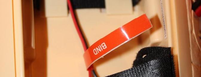

Radio Installation
Since it was necessary to move the rudder to one side to install the vertical stabilizer and elevator I decided to bind the receiver before installing the vertical stabilizer. A binding extension wire runs from the receiver into the battery bay that is accessed in the front bottom of the fuselage. I connected the supplied binding plug into the extension wire ant with my DX7s transmitter by me I connected the flight battery pack to the ESC and bound the receiver to an available channel on my transmitter. Once that was complete I held the rudder over for a hard right turn and disconnected the battery pack from the ESC with the rudder extended out hard to the right.

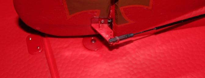

After the Albatros was fully assembled and the elevator control horn connected to the elevator control rod; I came back and made sure all the servos were moving in the proper control directions.
