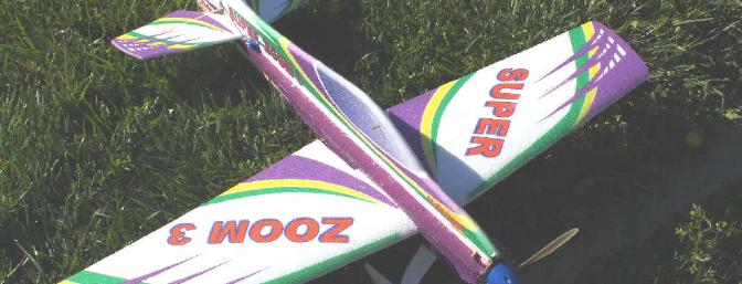

The Super Zoom 3 is available in your choice of red, blue, or violet color schemes. My violet Zoom arrived safely and neatly packed in a sturdy flat box. There are a minimum number of main parts - a fuselage in three pieces, a wing in two pieces, stabilizer and vertical fin. The control surfaces are integral to the wing, stabilizer and fin, so there are no hinges to mess with. Hacker does the hard work. What is left for the purchaser to do can be accomplished in an evening.

The Super Zoom 3 Construction Guide illustrates assembly in 40 steps. I followed the Guide's assembly sequence, but here and there in the following text I suggest alternative procedures .
All gluing is done with regular CA. Foam safe CA is neither required or desirable. Hacker specifies use of accelerator on each glue joint.
Be sure to use sharp blades for all cuts. Dull blades will tear the foam. For cutting slots to embed carbon fiber reinforcing rods, one of those little knifes with a slide-out blade (see photo) can be used to limit the cut to a preset depth.
Here is a general suggestion
The carbon fiber reinforcing rods are glued into slots cut into the various foam parts. The ESC, radio receiver, battery pack, and servos are all pushed into holes cut into the wings and profile fuselage. All the various wires are pushed into slots cut into the profile fuselage. Instead of doing these tasks when specified in the Construction Guide, I think it is easier cut all the slots and holes (except for the one that houses the battery) first before doing any assembly. It is easier when you can lay the separate parts on a flat surface.
The first assembly step is to join the two wing halves.
When I butted the two wing halves together on a flat surface as instructed in the Guide, I found that the butt ends had been cut with a slight angle that would produce dihedral if the two panels were fitted tightly; however, the Construction Guide has nothing to say about dihedral. Flat wing or dihedral? Which would be better? I suspect flat out full bore 3D pilots will want a flat wing and will do a little sanding to square up the panel ends. I'm not that gung ho myself and decided a bit of dihedral would suit me best, so I left the wing panels as is. Of course I had to shim up the wing tips a bit when joining the panels.
Next carbon fiber reinforcing rods are inserted into the wing panels by cutting 3 mm. deep slots into the top of the wing following measurements illustrated at Step 2 in Construction Guide and glued with CA and accelerator. Next they are installed on the bottom of the wing.
Following the measurements illustrated at Step 4 in the Construction Guide, openings for aileron servos are cut into each wing.
The Guide leaves installing the servos into the wing for much later in the assembly sequence, but I think it is easier to put them in at this point while the wing is still separate from the rest of the plane and easy to work on.
A straight fuselage is important Hacker guarantees this by providing thick foam stiffeners to glue to each side of the fuselage. The Construction Guide's procedure is to place the foam fuselage on a flat board and glue a foam fuselage stiffener to it and then, placing the fuselage on the edge of a flat board gluing a stiffener to the other side. After that, a 3 mm slot is cut into each fuselage stiffener and carbon fiber rods are glued in. I found it difficult to cut a long slot in the stiffener while the fuselage was balanced on the opposite side's stiffener, or while supporting one haIf of the fuselage side on the edge of a flat board. I think it is much easier to glue the reinforcing rods into the stiffeners first and then glue the stiffeners to the fuselage.
The wing can be slipped through the fuselage, carefully aligned, and glued it in place.
Tail
The Stabilizer and Elevator are one piece. A spruce joiner is glued into a precut slot to join the left and right elevator halves. When dry, the elevator should be flexed a few times to break in the hinge. Then a control horn can be glued in place and the stabilizer can be slipped into a slot in the fuselage, aligned, and glued.
The rudder is prepared and attached to the fuselage in a similar manner.
Radio Installation
Pushrods to operate the ailerons, rudder, and elevator are built up from carbon fiber rod, Z-bent wire and shrink wrap tube. After the tubing is shrunk, the assembly is secured with a drop of CA at each end. Excellent pushrod connectors that are an exact fit to the carbon fiber pushrods are supplied in the kit.
Pockets for aileron servos were cut into the wing at an early stage. If you chose not to follow my suggestion to glue the servos into the wing at that point, do so now. Install aileron control horns and connect the ailerons with a z-bend at the control horn and a mini connector on the servo arm.
The rudder servo, elevator servo, battery pack, and ESC are all installed by pushing them into appropriate sized openings cut into the fuselage. All the openings are cut slightly undersized. The fuselage will stretch when parts are inserted and will hold them with no further support needed.
Motor
The motor is attached to a motor mount made from plywood parts. Shame on me! I forgot to photograph this step, but the parts are visible in the bag of small parts. The mounted motor is attached to a corresponding part glued into the nose of the fuselage.
The location of the ESC, radio receiver, and lipo battery will depend on the size, shape and weight of the equipment chosen by the purchaser and on the necessity of achieving a correct CG. with a balance point 120-130 mm aft of the leading edge of the wing. Cut the required slots and holes for everything except the battery. Install all other equipment. Then attach the battery with double sided tape and move it until the the airplane balances at a point where the CG is correct. Once the proper place for the battery is located, cut a hole for it.
Suggestion:
I insert a small dowel through the cockpit directly above a point 125 mm aft of the leading edge of the wing. I can then very conveniently check CG by lifting the airplane with a fingertip at each end of the dowel.
The Super Zoom 3 is now complete and ready to be admired.
