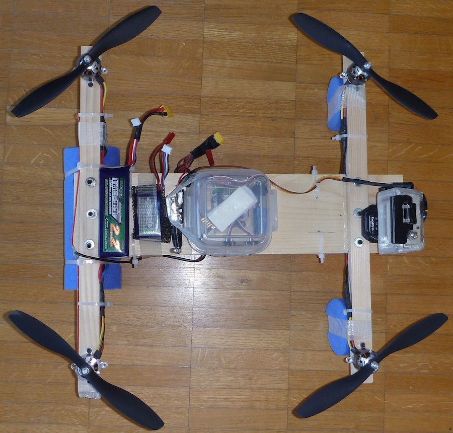

You have also build an H-Quad ?
A topic to make a list and help those who would like to make one.
Add yours with a description / photos / video or a link to your topic.
I start with my first rc build from scratch.
A central plate of wood 40 cm x 10 cm x 1 cm.
Two arms 40cm x 2.5 cm x 1.5 cm
47 cm between the motors (diagonal)
=260g
openpilot CC3D
NTM 28-26A 1200kv & Series Accessory Pack
ESC 30A Flashed with SimonK FW from opstore.eu
8"x4.5 Carbon reinforced AP Propeller from flyduino.net
Gopro HD2 - Turnigy 9x - DragonLink
2200mAh 3S 25C Lipo (nano-tech or zippy compact)
AUW: 1300g
Autonomy: about 7 minutes.
