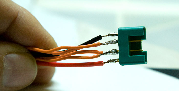

I picked up this nifty six pin connector to power the wing...
I wanted to avoid having four connectors, one for each of the wing's servos. The red positive wires connect to one pin, the brown ground wires connect to another pin. Then each of the four orange signal wires goes to its own pin...
I'm still deciding if I should glue this in solid or leaving it loose...
Here's the other end exiting the bottom of the wing...
Shockingly, everything seems to be working. That never happens! *grin*...
Now that the servos have power I can proceed with installing the flaps & aileron linkages.

Your 6pin harness is great. I recommend using a hot glue gun to pot the wires as strain relief as this will keep the wires from breaking at the solder joints in years to come. I don't use heat shrink either as the hot glue takes care of that as well.

Yeah I wasn't really happy with the job I did on the connecters. I decided to start over & see if I could do a better job. I de-soldered everything & this time I tinned both the wire & the pins first. I still have a little more solder on there than I'd have liked but the connections look & feel much better...
One of my biggest concerns is stress on the connections, especially as I'm not planning to anchor these to the airframe, gonna leave em loose. So I took your advice there Curtis & instead of heat shrink, I used hot-glue to bond everything together in a nice static lump-o-glue...
I figure this both insulates & immobilizes. A little heat shrink finishes her off nicely...
Thanks a bunch for the hot-glue tip, very cool.

I'm here to tell you that the re-work is worth the effort. I just stuffed my plank today due apparently to a wiring fault.
GOOP is also a very good insulator for this type of connector.

Yeah liquid tape is great stuff. I'm not sure it'd be ideal for this application however. It remains somewhat flexible which is great for insulating & water proofing, not so great for keeping connections from flexing. The hot glue, on the other hand, basically forms a lump of plastic once its cooled. Both have their uses though, thanks for the link.
