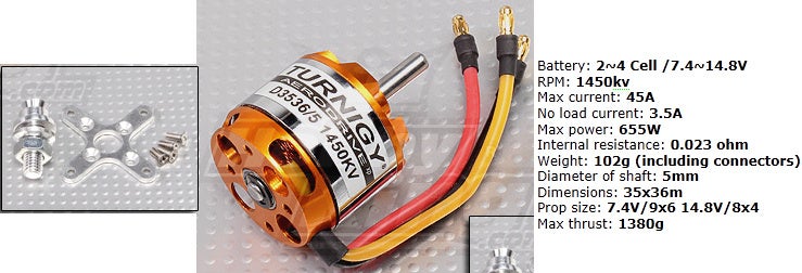

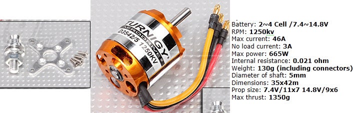

7.) Some folks have put in more powerful motors, and gotten great performance as a result. This usually requires a higher-amperage ESC, and possibly a different battery. Some of these motors bolt right in and are a direct replacement with little effort needed. Others are larger diameter and need the plane's motor pod hollowed out, and sometimes the motor mount modified. Keep in mind that the SSS is a powered glider, not a racer or a stunt plane. Fast, steep climbs can be fun, and even useful at times. But if you want super aerobatics or high speeds, you're probably flying the wrong plane.
Bolt-in, 655W, steep climbs: http://www.hobbyking.com/hobbyking/s...dProduct=18226
Needs engine mount mods, 1000W, vertical climbs: http://www.headsuprc.com/servlet/the...ushless/Detail
Lots of other motors, from many sources, are good too.

Motors:
Several posters have mentioned a motor from HobbyKing, that apparently bolts right in to the motor pod of the SSS with no modifications needed, in place of the original motor that came with the plane. The Turnigy D3536/5 1450KV motor is 35mm in diameter (same as the stock motor that comes with the SSS ARF and RTF planes). I think several people have already used it on their planes, and written about it here. I believe that the cross-type aluminum mount it comes with, is identical to the one that comes with the SSS (is this correct?) .
$16.90 plus shipping from HobbyKing: http://www.hobbyking.com/hobbyking/s...ner_Motor.html
Another motor looks almost identical, same diameter but a little longer. More torque, so it turns a slightly larger propeller, a little slower, and has a slightly lower KV rating. Weighs one ounce more, max current and power are just a sliver higher. Hopefully this will bolt right into the SSS too. Has anyone tried this one? Does it bolt in with no modification to the motor pod? I've ordered one for the new 2000mm-span "Super Sky Surfer 2000" from ReadyMadeRC. Looks like it comes with the same motor mount and collet-type prop adapter as its near-twin, above.
$18.85 + ship from HobbyKing: http://www.hobbyking.com/hobbyking/s...ner_Motor.html
