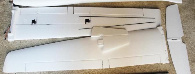

Pre-Assembly
The wings and stabilizers came in thick plastic bags and inside a thick brown box so they arrived in very nice condition. Before starting assembly of my standard tail Eagle 1 I worked all of the foam hinges to help break them in and make it easier for the servos to properly move them. I moved the rudder back and forth 30 times full throw in both directions and the same with both sides of the elevator. For the ailerons I disconnected the control rod for the aileron control horn and bent the aileron back and forth 30 times on each wing half and then reconnected the control rod to the aileron horn. I did the same for the flap control surface on both wing sections but focused more on bending them down only bent them up slightly. I reconnected the control rods to the flap control horns. All of the control surfaces moved more freely after this quick break-in bending exercise.
The wing came assembled in two halves. As mentioned above flap and aileron servos were mounted in both wing sections with their wires coming out at the root of each wing half. Using colored tape I marked the aileron connectors with blue tape and the flaps with yellow tape. Y-connectors came with the kit and I marked one pair with yellow tape for the flaps and one set with blue tape for the ailerons. There is a very long wing rod that goes into a long tube in both wing sections and there is a two piece plastic wing connector box that mounts from the top and bottom sections of the wing with two circular wing mounts per wing half that fit into holes on the wing section. The top piece fit into the holes on the top of the wing perfectly. The bottom four mounts were slightly larger then the holes in the wing for them. Four screws were provided to go into the mounts on the top of the wing to be screwed into the section under the wing to join the two halves together. All four of my screws were the same size and all fit the back mounts where the foam was thinner in the wing. I found two 4mm size screws that were about 3/4 inches long that fit the front mounts of the wing joiner. The wing will later mount to the fuselage with two supplied plastic bolts going through the wing joiner box. A two part tool was supplied to tighten and loosen the bolts. I glued the metal part into the plastic handle with some Shoe Goo. To separate the wing back into two halves one only has to remove the four screws and take the wing joiner box apart. I plan to leave my wing assembled in one piece for both storage and transportation which makes for very quick assembly at the flying field. I took this opportunity to add some of the supplied decals to the wing. I added some of the supplied decals to the top and bottom of my wing for color. (My wife was startled one day when she spotted a lizard on the wing as she first thought it was a real lizard as she hadn't noticed lizard decals before.)
The fuselage came very nicely packed in plastic wrap and inside its own brown box for protection. It arrived with the motor and speed controller installed along with the folding prop and spinner. Further back in the fuselage were the installed servos for the rudder and elevator along with the control rods for the elevator and rudder and an adjustable connector for them on the servo arms for the rudder and elevator servos. I loosened the connectors on the control rods and bound my receiver to my transmitter and connected the rudder and elevator servos to the receiver and centered the servos. I carefully started to cut off portions of the control rods in front of the servo as the control rods were too long. I installed the wire with the 90 degree bend into the respective rudder and elevator control horns. I looked in the little bag of hardware for some wire keepers but there weren't any, only clevises that were not needed.
Mike's Standard Tail
The vertical and horizontal stabilizers fit together and fit into spaces on the back of the Standard tail fuselage. I used foam safe CA and fit and glued the pieces together and onto the back of the fuselage. Later I had to add more glue to one side of the elevator/fuselage bond so I made sure I had a good even coating of glue and while I pressed the parts together I had a friend spray some kicker on the spot. Now my tail and fuselage are one. A bunch of clevises were supplied with my Eagle. Unfortunately, there is no need for clevises but I could have used two control rod keepers. Both the elevator and rudder control rods had a 90 degree bend in them with the short bent portion to go through the control horns on the rudder and elevator. I did that and then put a small drop of Shoe Goo on the end of the control rod and let the glue dry. The drop of glue would serve as a keeper on the control rod in the control horn if needed. So far both control rods appear to be staying right in place in the control horns and that is with the test flying completed.
Richard's V-Tail
The V-tail comes with a fuselage designed for the Standard Tail to be fitted in the back and includes plastic mounting hardware and screws. Richard used those along with Foam safe CA to assemble the tail onto the fuselage and said it was straight forward and he just followed the instructions and did as shown in the pictures. He also got unneeded clevises and hinges but he had some keepers in his parts supply and he used on his Eagle as can be seen in the pictures. With the assembly done it was time to consider the programming options. The V-tails are connected to two servos which on the Standard Tail control the rudder and elevator. At a minimum the servos can be programmed to operate the V-tail as elevators only or mixed to work as both elevator and rudder.
Richard chose to program the V-tail as elevators only. Thus he uses the ailerons as the main turning control and the V-tail as elevator control. I borrowed Richard's Eagle I and using my transmitter programmed the tail to have a mix of elevator and rudder. This will be discussed below in the flight section.
