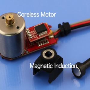

Hall sensors can't be that expensive because this uses a hall effect sensor and sells for $23.99. (this is actually a relabled Blue Arrow DMS-28013MG)
http://www.hobbyking.com/hobbyking/s...11sec_26g.html
Internally it has a sensor chip on a daughterboard and a plastic housing with a magnet on a shaft that slides over it. The magnet sits just above the chip and the servo knows the position of the output gear by sensing the direction the magnet is pointing.
Great servos btw, really smooth with good centering and almost nonexistent deadband. I'm using them on my Tarot 500 and I can crank the cyclic gains almost to maximum without causing cyclic wobble. Makes me wonder why Futaba and Hitec aren't doing this.
EDIT: Beenflying posted some information about these chips in the 450 thread a while back. He was the one that recommended these servos to me.
http://www.rcgroups.com/forums/showt...9#post23201004
http://www.rcgroups.com/forums/showp...postcount=7038

Originally Posted by Atomic Skull View Post
Great servo btw, really smooth with good centering and almost nonexistent deadband.
you are lucky because I have not heard the same from other helicopter pilots.
as far as I know there is no other international distributor besides HK, it remains a chinese servo for me.
I have the dealer price list of many chinese servos, I don't buy because I don't trust them too much.... only for foamies.
last week I got the price list of these new servos, they look not bad on the paper
JR uses this technology (hall effect sensors) in their high end servos and charges a premium for it, which is bull because these hall effect sensor chips were developed to provide a lower cost alternative to high quality pots in consumer electronics not because they're more accurate.(they aren't, just better price vs performance and they last longer)
