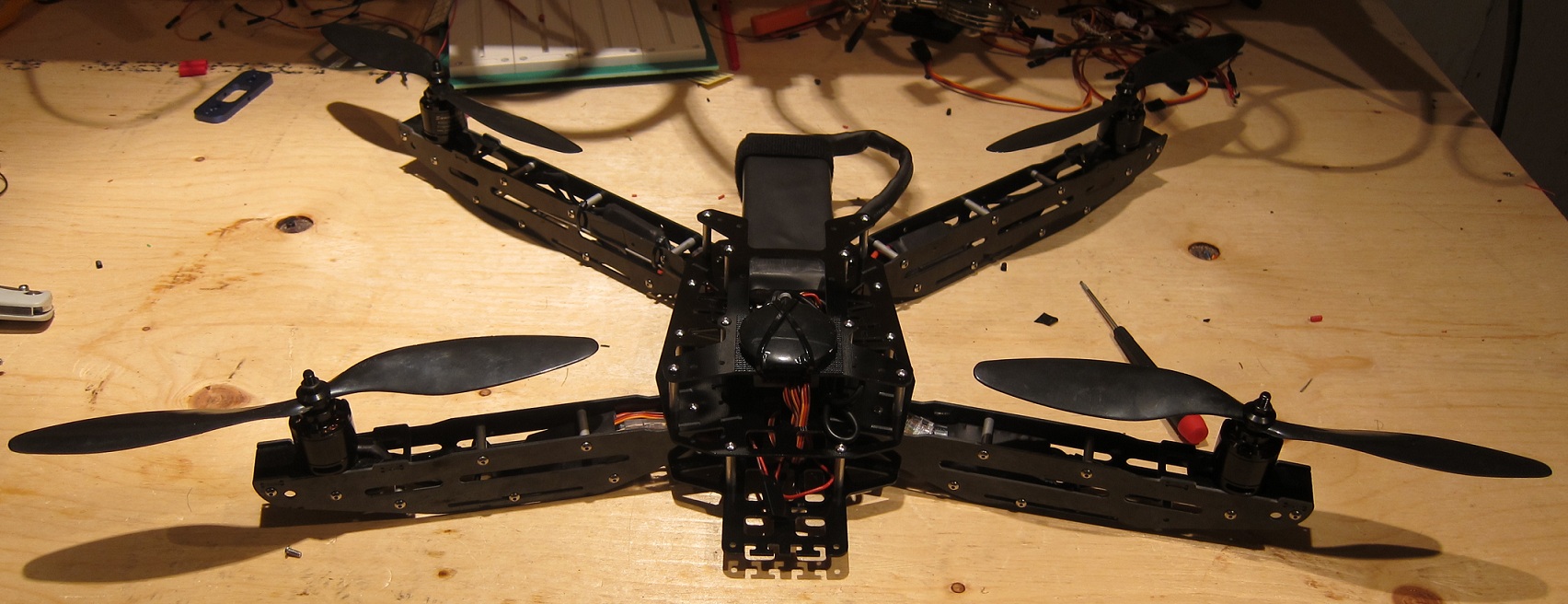

Ok don't shoot me for saying this, but I seem to be one of the only people really unhappy with the way this frame flys.
I have my frame completely built, flying and hovering relatively stable. Don't get me wrong, it flies alright, hovers fine etc. Just not great in comparison to the litany of other frames I've tried.
There are numerous things which i don't like:
1. Lack of symmetry in the arms; it changes the way the quad flies. it's just not quite as 'locked in' as frames with symmetrical arm distance. Also get random changes in yaw, and elevator seems to be more sensitive than aileron due to the arm spacing.
2. Specific COG: the COG on this frame is just in front of the rear arms. If your battery is slightly too far back, or too far forward then you are not on the COG. It seems to be too sensitive in getting the COG exactly right. Plus there is not enough room for larger batteries to slide in between the slot on the top protection plate. It seems to only work fine if you use it in the standard config; i.e. go pro at front, 3000-3400mah battery on back. If you want to mount your battery on the top plate, or add your go pro protection case the COG is thrown way off again.
3. Short flight times: people (including me) are getting around 5-8mins flight on these frames. I want 10min plus. 5 mins flight is not goinhg to get you far seeing as you want to leave enough to get back!
4. On my F450 I had everything setup and flying awesome on a relatively crap frame. the only issue I had was the props in the go pro view. I would get 12minute flights, with NTM35-36 960kv motors, 11x5 props and 5000mah 3s battery. Plenty of power, nice and manouverable although it was no acro quad.
I'm going to mount the tppacks go pro isolator on the f450 frame and see if that helps to get rid of the props in view. Alternatively I will have a look at the QAV500, however I'm not too keen on their aluminium arms.
Either way, I may have my HTFPV frame for sale soon, so anyone interested can pm me to get in early!

I'm not sure what you mean. I have 980kv motors and a 5000mAH 3S battery on mine. The top plate is tight, but it holds the battery in place extremely well. I only have a single velcro strap on as added security.
I don't think the COG needs to be where it says in the manual, that's just a guide.

I've tried putting a 5000mah 3s battery in and it doesn't fit in the between the top plate. I have to stand it up if I want to place it htere.
If I have it so that the COG is in another position other than where it should be, my quad will drift heavily forward or backward. So i have to have it as close to the COG as possible. the weird thing with the way this frame is designed is a small change in the placement of your battery etc will have a drastic effect on the COG of the craft.

Does anyone have a setup which is able to get them 10+ minutre flight times? I had mine with the NTM2826 motors 3S with 9" props and I need a slight power increase and am only getting 5 min. Was thinking of changing motors to the Gaui 500x motors with 4s battery and 9" prop. Has anyone tried these motors with this frame?
I'm going to try and make some changes again tonight to see if they make a significant difference. If not I'll probably try out another frame

I usually get at least 10 minutes, if not more.
There is my 5000mAH battery in. Here is what I found works best. Remove the fasteners from the second row from the back. Loosen the back row so they are barely threaded. Put the battery in. Tighten the back row all the way. The plate will bend slightly, but it's not a problem, and the battery is pretty wedged in there (It's not going anywhere). CG should be in the right spot as well. To remove, loosen the screws about 4 turns, pull out.
The picture has the second row from the back connections there, but I found it's easier to manage the battery with them gone, and the battery adds support to the plate anyway.
Only down side is you need to have your screw driver handy, but swapping a battery takes a whole 30 seconds. The up side is the added security to the battery.

That thing is mean looking - wishing I bought black now
More pics if you get a chance!
