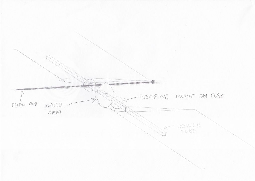

Thought Sean was devising a 180 degree rotating stab? Can't have it hinged -- or is this an executive decision?

Did a lot of thinking on the elevator and rudder for my new design .
This is what i am going to use on elevator .
Mad cam can be passed into the fuse with the push rod then you slide the square carbon axle through it then put you tails on .
The only thing i haven't worked out properly is how to make the bearing support,needs more thinking
I have made a madcam with circuit board and fishing trace ,amazing no slop design it can go 180.
Hope this helps ,Shane
That's awesome!
Thanks Shane
I think the 1st one should just be a pretty conventional set-up.
I'll follow your lead on the next one as I would like to resolve the general flying characteristics first.
J

I'd like to see what you come up with the stab bearing plate Shane.
Also the push rod/cam connection.....
