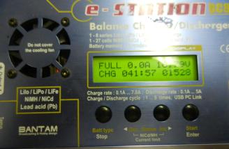

I started with the 2200mAh pack in the T-28. As mentioned previously, the first charge on the pack was at 1C with subsequent charges at 2C. I used my existing packs as bench marks to test against. These packs are popular brands that are widely used, and although I don't mention them by name you can probably guess what they are. These existing batteries have the same capacity as the Genesis pack, but only have a 25C rating. Naturally I was expecting to see a difference as a result of the jump from 25C to 65C. The Genesis Power pack was about the same physical size as the pack I was already using, and fit into the T-28 perfectly. I flew a couple of flights back to back, alternating packs to get an idea of the difference.

This pack arrived with an average charge of 3.8 Volts per cell and standard storage voltage per my understanding for LiPos should be 3.70 to 3.85 per cell. The Voltage therefore was appropriate for storage and the initial charge balance of the three cells was perfect with all three cells charged individually at 3.80 Volts. I charged the pack for the first two charges at 1C, 450mAhs. I discharged the battery pack by flying my Multiplex Merlin using the pack.
