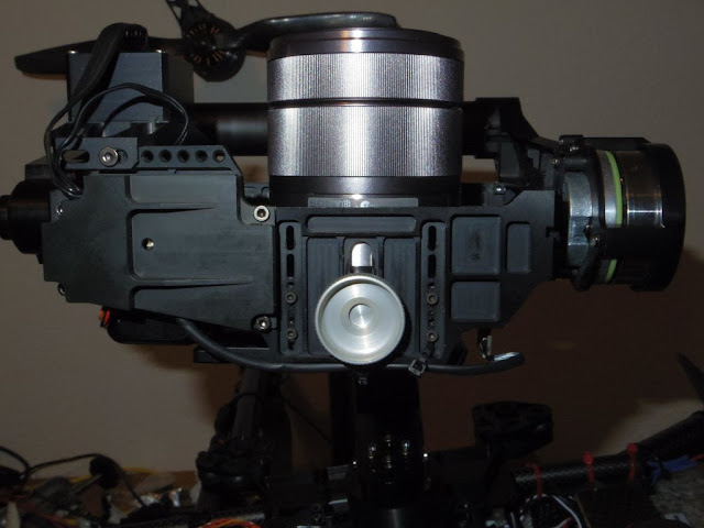

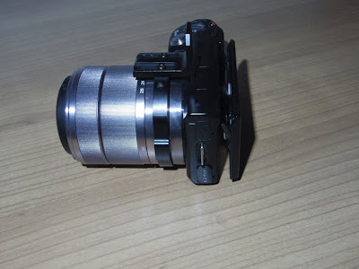

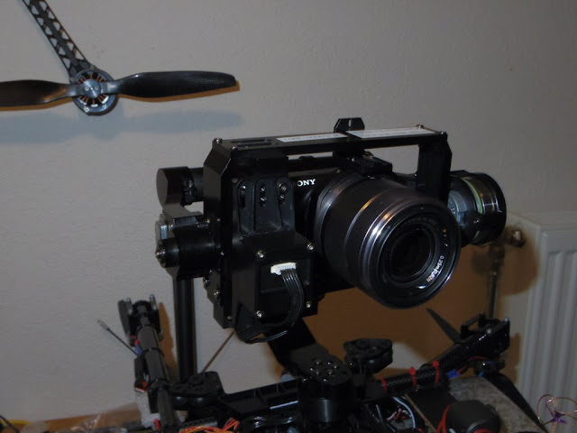

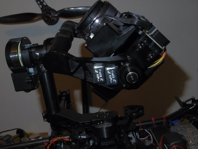

Hello,
Here a short description of what I did to balance for the new lens:
THIS IS NOT RECOMMENDED!
IF IT WORKS FOR ME IT DOES NOT MEAN IT WORKS FOR YOU!
USE AT YOUR OWN RISK!
It turned out, that I had to lower the COG on the cam, which I did by adding 10gr on the backside of the display.
I am using the display (-positioning) also for a fine-tuning the COG of the cam.
To get the cam balanced (front-rear) adjust the tray-position (on which the cam is mounted) by opening the 4 screws, adjust the position, and tighten the screws again:

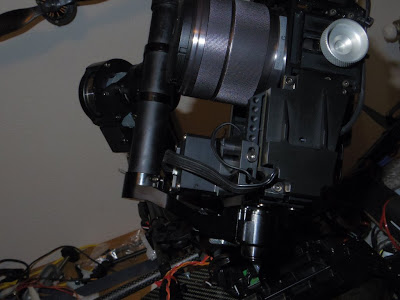

You should balance this like a prop, at every position you put the cam, it needs to hold its position. If you add the cover for the lens, the cam should move and point down. Since the gimbal has a bit of resistance, you have to push a little to the one and to the other side, and see if the reaction is different. You do this for every axis individually, starting with tilt.

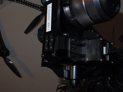

For the roll-axis, I had to add 10gr at the side where the IR-TX is sitting. The fine-tuning is done by adjusting the box containing the IR-TX using the screws there:
That´s it, takes about 5-10min.
Be sure to take off the lens-cover when balancing!
best regards
Ferdinand
