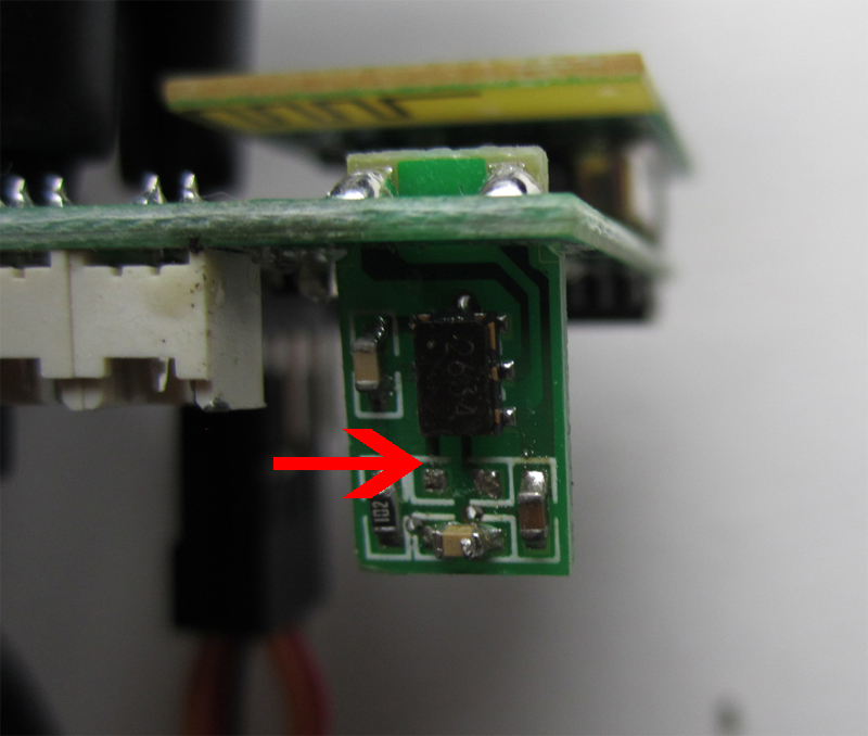

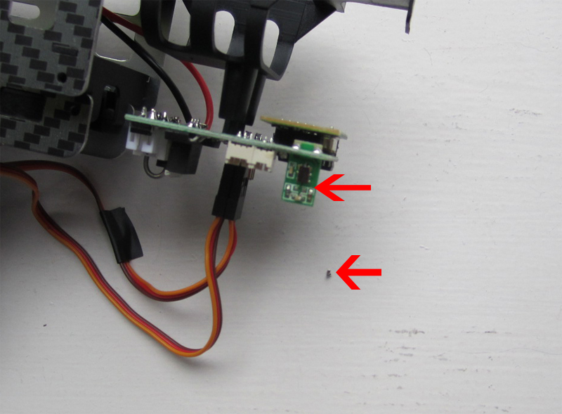

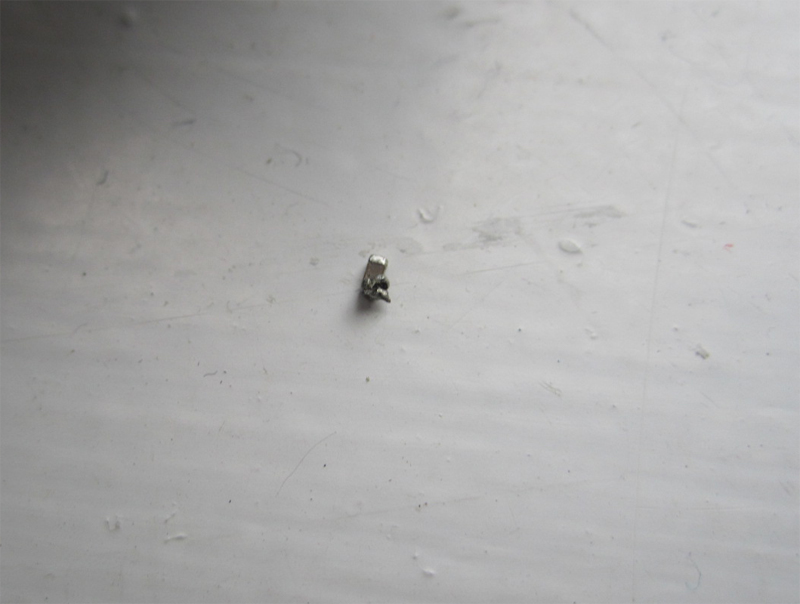

Oops
I am building a second F45 from scratch now and i tried to pull a little sleeve over the gyro...and oops something fell off. It's so damn small lol but i managed to solder it back on and it works . It looks bad but it works ha ha.
