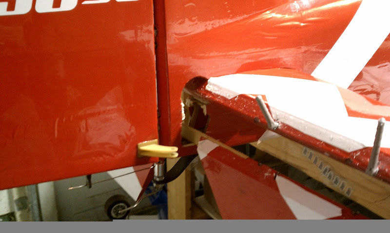

ok, so after some hard flying of the 70" Slick, I noticed the my elevator hinges are a bit loose. What is the best way to redo the hinges? Of course I can't take the elevator all the way off because of the rudder.
How loose are they ? I had three loose one on my 89 Slick, I used thin CA and used one of those pipetes wit small tip and dripped it in the hole. Has held firm for a few months now. Also, if they are loose on the elevator side, the pin goes all they way thru the balsa, you can cut a small section of Ultracote to expose the pin, fill gorilla glue, med CA then patch the ultra coat.

I think I am going to go the thin CA route. Some of the hinges are still tight. There are 3 hinges that slightly pull out about 1/8 of a inch. If I put vaseline around the hinges, then carefully apply the thin CA, that should work, right? I think this is my best option considering more than half the hinges are still secure.

The problem I've had with hinges is not necessarily the pins coming loose from the wood (although I have had this happen too), it's the actual pin inside the hinge wearing out the plastic and causing failure. Actually had the rudder on my 72 depart ship during a snap once. Landed the plane with the rudder flappin in the breeze held on by only the servo linkage. That was exciting!
When I noticed the elevator hinges getting loose I opted to replace them since I did NOT want the elevator jumping ship mid flight. It didn't seem physically possible to install new hinges without cutting up the tail of the plane a little. I just couldn't get the elevator back far enough to make enough space to insert new hinges. Wound up cutting through the bit of wood at the bottom of the hole that the elevator joiner goes through, which allowed the elevator to fall into the lightening hole below it. This gave me the room I needed to work.
I think I have a picture of this somewhere. I'll see if I can find it...
Found it:
And just for fun, here is a photo from when the rudder came off.
