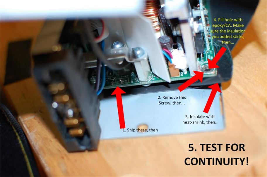

Originally Posted by rchelijc View Post
Tjinguy's site here was my inspiration, so I followed his pics with success.
The only thing I'd change is shorting pins 6-8-10 instead of the 6-9-10 which he suggested. Reason is posted above...
I have been using the DPS-600 for a year now with no problems. I am just using one for a 12v power supply. I converted it per the TJinTech article. I just now came across this thread. I did not try soldering the pins but rather used the servo leads and twisted and soldered. Is the any advantage to using the 6-8-10 jump over the 6-9-10? I have never done the 4-8 jump to quite the fan, is there any risk of overheating the ps by doing so? It sure would be nice to quite this down some
Regarding this image from above post, if I wanted to connect binding posts would the center two silver round head screws on standoffs be the location internally to connect to? (The red #1 arrow is kind of pointing to them)

Pin 9 is the voltage control pin, so it would limit your output voltage (rchelijc actually pointed that out in the post you are linking).
As far as fan control, I would not recommend slowing the fan without some way to speed it up if needed (i.e. if you are drawing a lot of current or it is running hot). If you think about it, server rooms are kept cool and I am sure they have these fans running full speed when the PSU is working hard because heat will destroy them.
I am working on perfecting a temperature control circuit that will be able to be installed in these fairly easily so that when it is cold the fan will run as slow as grounding pin 4 to 8, but then will speed up linearly and reach max speed when the PSU is at max temperature/current draw. All that will be required to install the circuit is to epoxy a thermistor onto the heat sink, screw the leads down to the binding posts, and solder the 3rd wire on the ribbon to a wire on the circuit I am making. It is not done yet, but very close. I will let you know when it's done if you are interested. I am going to be selling these PSUs with the temperature control circuit already installed, but if you already have the PSU you can buy just the temperature control fan circuit if you are interested. If running two in series, each PSU will need its own temp control fan circuit. I haven't figured out for sure the price yet, need to figure cost of parts and how long it takes to make...
Edit:
Note, the fan does speed up slightly when current increases when pin 4 is grounded to pin 8 without a temperature control circuit installed, I think it is just a result of the noise from the high frequency switching going on inside the PSU. The speed up is only very minor with no circuit installed, not enough to provide proper cooling. At max current if you run it and heat things up as hot as possible the fan will only increase about 2.41 volts. I measured this when experimenting with the PSU hooked up to the dummy load I made. But, the fan needs to speed up to full on when the PSU is at full capacity to really provide proper cooling and preserve the life of your PSU. My temperature control circuit will be tuned to do just that but then allow it to be quieted when the higher speed is not needed (best of both worlds).
