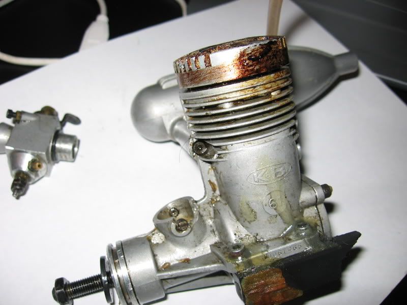

Hi all, I purchased a K&B .61 from a Forum member here, and sad to say I was a little more than disappointed with my purchase as it was advertised as having a "slight flaw that won't affect the performance of the engine". I agreed with the seller to a 50% refund instead of sending this lump back to the seller. I probably would of had to send it as Hazardous Waste ! So, I gutted it and then found a used and tired K&B .61 that had compression problems. I used the case from the second engine and transplanted everything into that from the turd engine, the internal parts were actually in pretty decent shape. So, can one's man garbage be another man's treasure ???
Here's the before pic of my Forum purchased K&B .61 with a "slight flaw", yeah, right:
Here's the after pics with everything from the junker switched over to a used case that I did a little restoration on, what do you guys think of her now ???:

OOPS ! Looks like I missed a little baked on castor between the fins on the head..... May have to fix that, Shoo

Did the early .61s come with Perry carbs? Is the Perry venturi small enough to run it without a pump? I've never had a K&B .61, but have several 7.5s with pumps and big Perry carbs, intended for ducted fan use prior to K&B's introducing their rear rotor D/F engine.
What did the good case and head look like before you cleaned it up?

I don't know if the K&B's ever came with Perry carbs, the second engine I bought had it on it so that's what I used. I actually used the head from the first engine, and the case from the second. I should have taken a picture of the second engine case. It was in okay shape, I stripped it down completely and then bead blasted it. The head from the second engine was quite carboned up, everything seemed very dry and the ring was stuck and broke easily when I tried to remove it, probably the reason for the poor compression on the second engine. Thanks again, Shoo

the .61 originally had the old "box" style carb with the L shaped main needle. the venturi was also rather large. i had two of them. i still have a complete carb from one of the old .61s i had. Randy, if you dont want to use the perry carb the old box carb is actually pretty good. the one that came with the .65 sportster will also fit.
