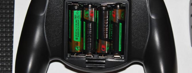

NONE! Unless you consider installing the 4-included AA batteries into the transmitter to be "assembly."
