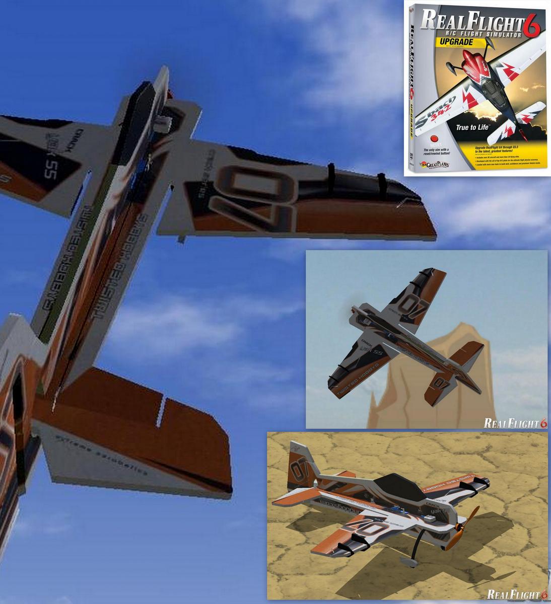

Crack Yak now available for Real Flight! Here:
