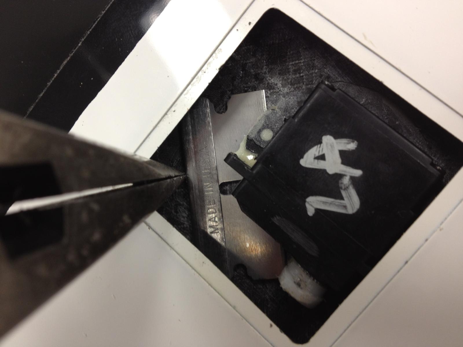

Anyhoo I just wanted to share my pain; for ailerons, previous owner epoxied the 171s (noisy, lots of play most likely responsible for flutter) into the wing.
With lots of epoxy.
I can't budge it so it looks likely a Dremel job dammit.

These usually come out easily. Use a square-tip Dremel to remove part of the glue fillet, drop a razor blade in there, tap with a hammer, and it'll come right out without stressing anything. Rest the wing on foam so it doesn't get scratched. The key is to use something heavy that fits the razor blade very well -- the standard-size needle nose pliers in my pics are the best I've found.

Servo popped-out thanks to the scraper blade trick but mostly from leverage using the M3 allen bolt and gentle persuasion and colourful language. Words like "Crikey!" and "Cripes!".
Here's a tip; take a chisel blade, heat with butane torch and use the reverse-side to remove epoxy. Use gingerly and keep the blade moving to prevent any heat damage. Much less hassle than the dremel grinding and in my case, didn't affect the top skin at all.

Another option is a Hobbico Hot Knife with a chisel blade to remove epoxy. I always place a cold rag under the skin and take it slow but I can make a servo bay look virgin again with this method.
