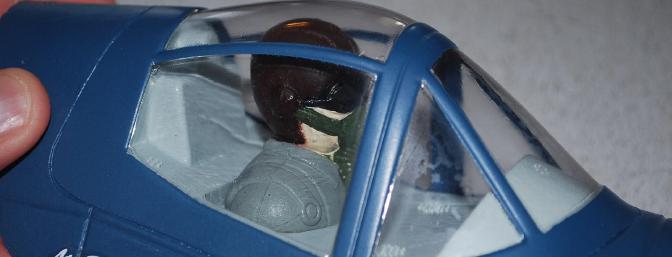

The F4U Corsair had a nice included painted pilot figure. He is actually decent looking too and it was great to see this detail on a budget-priced model. Excellent work Tower Hobbies!
The canopy is very secure with strong magnets no worries about accidental loss while in flight.
