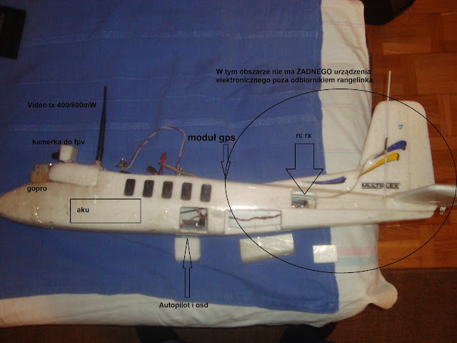

Originally Posted by karolpenconek View Post
http://www.youtube.com/watch?v=KkoHQ8YRdM4
Flown on Rangelink, stock antennas and all time 200mW mode
My plane:
FPV Base:
Multiplex Twinstar II fpv
35-30 motors and 30A escs
4s 12Ah lipo
rvosd 5
rangelink UHF LRS
1.3ghz 800mW vtx + 13 dbi double biquad antenna in base
Pixim 690tvl camera
Nice , Great work, Many thanks for your share.
